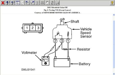

KHLOW2008
  • 41,814 POSTS

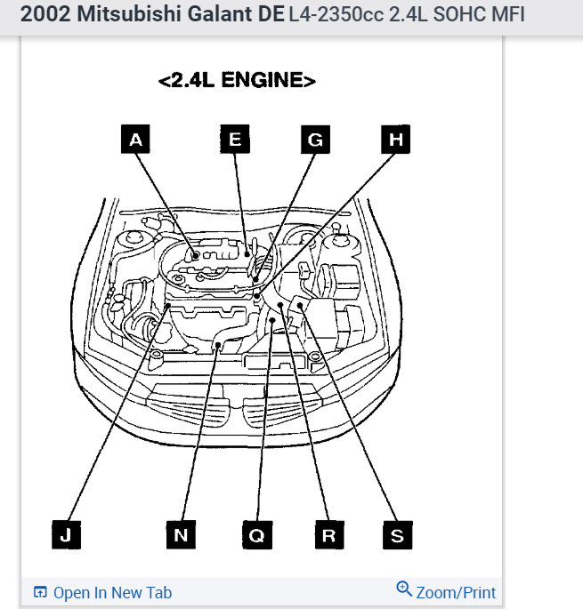

Hi willv28, Thank you for the consideration. Mitshubishi is a funny system, quite a number of malfunctions do not show on the CEL but a scanner would retrieve the codes. Vehicle speed sensor (VSS) Remove VSS from rear of transmission or top of trans-axle. Connect 3-10 k/ohm resistor as shown in figure number six . Connect voltmeter between terminals number two and three. Spin shaft of VSS and check for voltage pulsations. There should be about four voltage pulsations per revolution. If there are not four pulsations per revolution, replace VSS.
https://images.2carpros.com/forum/automotive_pictures/192750_VSSTesting02Galant_1.jpg

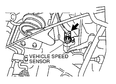

WILLV28
  • 22 POSTS
I am sorry I am being such a pain. But I did not find it. It is just dark when I get home. I did go by this picture as additional help from my manual. I am not hugely mechanically inclined, but, I know I could do this if I could just get to the part.
https://images.2carpros.com/forum/automotive_pictures/103998_29149_mits_g0134_1.gif
Where it is in this picture there is just what looks like a flat plate inserted instead?
Dec 10, 2008 at 8:21 AM

Hi willv28,
Do not worry about asking many questions. You should be sure of what are required before proceeding with rectification and any questions should be asked to get the correct answer. I would not like you to go into a job without knowing or understanding the situation. That would be bad and instead of rectification, more harm might be derived and time and money would be wasted.
Unplug the wire harness and the part below it is the speed sensor.
Thanks for the picture, it helps. I am going to download it to my PC as I was not able to find a suitable one from my database. ;)
Dec 10, 2008 at 8:42 AM
WILLV28
  • 22 POSTS
Where that picture shows is nothing, just a black flat plate, no wire harness or anything. I do think I found it though. It was on the part of the transmission directly under the battery. It translates as "supply speed sensor" in google. I do not know why the only references to the part number on the part are in Chinese.

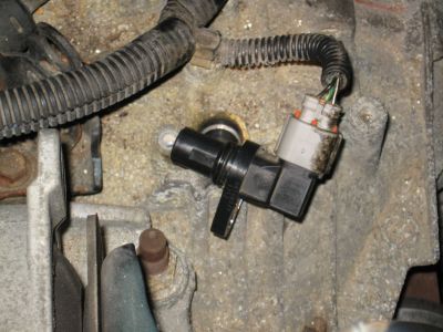

WILLV28
  • 22 POSTS
Okay, I was not able to get anything out of the sensor itself. The part does not "spin" as the diagram procedure says. I think they are referring to a different type. The part I find is identical to the one in my manual.
How sure are you it would be this part? Is there anything else in the electrical system, that might cause this? If I knew what the circuit diagram that the sensor was on, that would help me check anything else.
Ugh, what a time for this to happen while I am waiting for a real manual. Haynes manuals are not the best, lol.
Well, I now need to find the part. No one seems to have it the local Mitsubishi dealer wants me to take it in instead.
PS - The part number on the sensor is G4T08371.

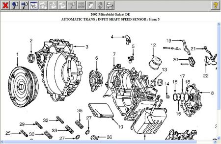

KHLOW2008
  • 41,814 POSTS

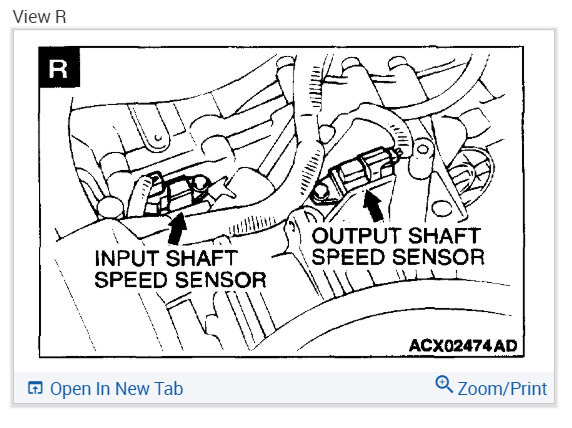

Hi willv28, The part that you are referring to is the transmission main shaft speed sensor It is not the vehicle speed sensor. From the diagram, look at item three. The VSS is located above the part where Item two (oil seal) is seated. Your picture shows either Item four or five. There are two of them. I am unable to get any parts information from my estimator.
https://images.2carpros.com/forum/automotive_pictures/192750_TranHousing02Galant_1.jpg

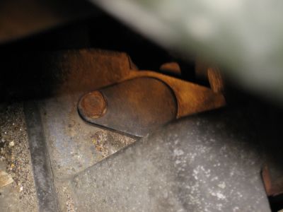

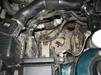

Maybe there is something wrong here. Here are some pictures from yesterday and today:
https://images.2carpros.com/forum/automotive_pictures/103998_IMG_0570_1.jpg
This is the view of the car from the driver's side. The part I found was pulled out in this picture. You can somewhat see the spot that was pointed out in that picture of the exact location I posed yesterday.
https://images.2carpros.com/forum/automotive_pictures/103998_IMG_0571_1.jpg
This is the actual part I pulled out. Matched what is in the Haynes manual but does not seem to be it.
https://images.2carpros.com/forum/automotive_pictures/103998_IMG_0572_1.jpg
This is a closeup of that location that is from what is pointed out in the picture from yesterday (which is below). That is what I find when I look there.
Could it be something is different about this car that what we are looking for? Because those are the only things I can even find. I just looked at all the areas and the last picture of my car comes closest to the location. I guess my confusion is for a reason. lol

Hi willv28,
We are in the same boat, both confused. lol.
Well, you are correct, the supposed location of the speed sensor is not being utilized.
I understand some models uses the shaft speed sensors for the speedometer and it is via the PCM. However, those that I found were all about a gear driven speed sensor.
I would try other models to see if I can come up with anything else.

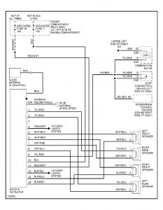

Well, did not need to go beyond step five.
Read the voltage of the wire. It was 5.5 volts. Turned the radio on, it went to 24.89 volts.
So, looks like I found the problem.

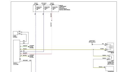

So, do you have a wiring diagram for the stereo harness for the 2002 Galant? I will rewire the radio (the harness was cut when I bought it). The diagram I had was not quite right. Make sure the voltage reads right with the radio on/off. Then I will do the repair to the circuit board.
I assume I am replacing the printed circuit board like it says. Whew, $35.00 part if true. Does not look too complicated, lol.
Anything else you want me to do before I order parts, etc? Please advise.

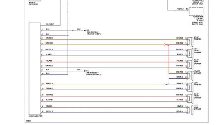

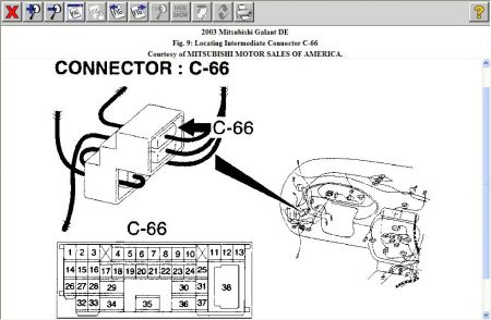

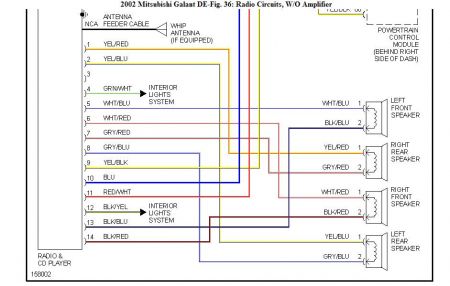

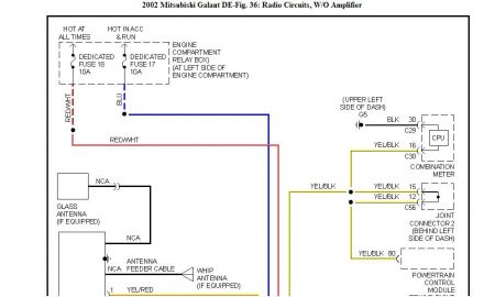

Hi willv28, So a simple spark sent us all over the world. If the printed circuit is out, you can have a look at which point it has fused and sometimes a soldering job with a fine wire might save you the $35.00 and the trouble of ordering the parts. I have attached the wiring schematics and the first part one and two are if the vehicle is equipped with amplifier.
https://images.2carpros.com/forum/automotive_pictures/192750_Radio02Galant_1.jpg
https://images.2carpros.com/forum/automotive_pictures/192750_Radio02Galant01_1.jpg
https://images.2carpros.com/forum/automotive_pictures/192750_Radio02Galant02_1.jpg
https://images.2carpros.com/forum/automotive_pictures/192750_Radio02Galant02a_1.jpg

Thank you very much. I think all this information combined solves my problem with the radio.
It appears the wiring diagram I got from someone was way off. But it does many total sense now why the voltage is coming in.
If this changes anything in the diagram, please let me know.
What happened was the diagram they gave me had the yellow-black radio wire going to the antenna power. So, that resulted in me pumping the antenna power into the PCM system when the radio was in tuner mode.
Hopefully I did not damage the PCM in any way.

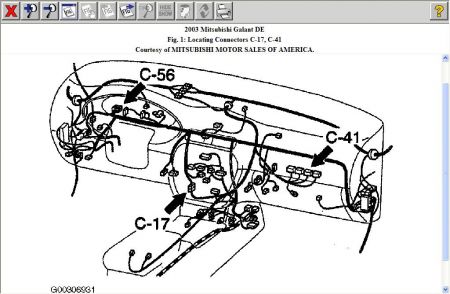

Thanks for all your help. Sorry this is long.
We have until Tuesday to fix it (I am dropping it off through overnight drop off). I have checked and double checked everything. Ran through the procedure, everything.
The only two small abnormalities are the resistance on the ground is way high, but the tachometer uses the same ground as does everything else and they all still work fine.
But, I thought I was high on voltage on the speedometer wire going to the cluster. It is at 4.00 volts even when key on "on" position. It says it should be fine. Going through both your and the service manual procedure does not yield any results. The voltage on the cluster power is 11.98 voltsand the speed sensor has 11.58 volts.
The garage is a good place, they already told me they were not sure if they could fix that part of it. That it is possible I could need to go to a dealer.
Other things of note the radio does not utilize the speed signal like the manual radio did, so that wire is unused. Also, I think the radio is grounded by a screw directly to the firewall, the radio harness has a ground wire that does not exist, should that be attached somewhere? there is no ground wire in the car radio harness.
Headache, lol
Jan 8, 2009 at 6:55 AM
KHLOW2008
  • 41,814 POSTS

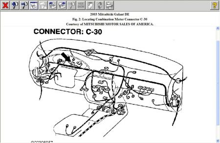

Hi Bill, The radio harness does not have any ground wires as it is grounded via casing to body. Since you replaced the radio, if it is a different system from original, you would need to add a ground wire. If the ground resistance is high, it means some place a connection is bad. Tachometer might be working but how accurate is it? Try adding a ground to see if it helps. Following is the test procedure for 03 models but a scan tool is required and I do not know if it is the correct match for your vehicle. TEST PROCEDURE NO. 1: SPEEDOMETER DOES NOT WORK To perform this test, Scan Tool MUT-II (MB991502) and Harness Set (MB991223) must be used. 1. Check the speedometer by observing the other meters. Check to see that the tachometer, fuel gauge and temperature gauge are operating normally. Do all other meters operate?  If YES, go to next step.  CAUTION: To prevent damage to the Scan Tool (MB991502), always turn the ignition switch to LOCK (OFF) position before connecting or disconnecting the scan tool. 2. Using scan tool, check the MFI system for diagnostic trouble codes (DTCs). Connect scan tool to the Data Link Connector (DLC). Turn the ignition switch to the ON position. Check the MFI system for diagnostic trouble codes. Is DTC P0720 set?  If YES, refer to appropriate Multiport Fuel Injection (MFI) DIAGNOSIS article in ENGINE PERFORMANCE. If NO, go to next step. 3. Check combination meter connector C-30 and PCM connector C-41 for damage. Are combination meter connector C-30 and PCM connector C-41 in good condition? If YES, go to next step. If NO, repair or replace the connector. After repair, the speedometer should work normally. 4. Check the wiring harness between combination meter connector C-30 and PCM connector C-41. Also check intermediate connector C-17 and joint connector C-56. See Fig. 1 , Fig. 2 and Fig. 9 . If intermediate connector C-66 or joint connector C-56 are damaged, repair or replace the connector. Is the wiring harness between combination meter connector C-30 and PCM connector C-41 in good condition? If YES, go to next step. If NO, repair the wiring harness. After repair, the speedometer should work normally. NOTE: If ECM (M/T) or PCM (A/T) is replaced, immobilizer-ECU should also be replaced. Each ECM (M/T) or PCM (A/T) has an encrypted code for immobilizer-ECU, and is registered in immobilizer-ECU. 5. Check the speedometer by operating the auto-cruise control system. Does auto-cruise control work normally? If YES, replace the combination meter. After repair, the speedometer should work normally. If NO, replace the PCM. After repair, the speedometer should work normally.
https://images.2carpros.com/forum/automotive_pictures/192750_WireHarn03Galant01_1.jpg
https://images.2carpros.com/forum/automotive_pictures/192750_WireHarn03Galant02_1.jpg
https://images.2carpros.com/forum/automotive_pictures/192750_WireHarn03Galant09_1.jpg
Jan 8, 2009 at 10:58 PM
WILLV28
  • 22 POSTS
Got nothing out of it. Could be PCM, the cruise will not come on, but I do not think it would anyway. The light used to come on at least even after the issue, now it will not.
I took the car to the garage today. I will be picking it up sometime tomorrow. Let's see if they can figure it out.

Electrical problem
2002 Mitsubishi Galant 4 cyl Front Wheel Drive Automatic
I have read a number of other posts regarding speedometer not working .
What I am wondering is at the radio harness the yellow/black wire what should it show a ground or power ? and if power what voltage ?
This is the wire that is connected to a number of other modules including the cpu. I recieved the car with the wires bare and no radio . I saw the speedo work once
Dec 11, 2018 at 4:50 AM (Merged)
  • 110,244 POSTS
After looking at the schematic, it runs through the CPU and other modules as you mentioned. When it goes through the CPU, it comes out to ground. Based on that, I would say it shouldn't have any power in it but rather is used as a ground. Here is the schematic. I hope it is big enough for you to see.
https://images.2carpros.com/forum/automotive_pictures/249084_5_47.jpg
Let me know if you have other questions. Also, there are two systems, one with an amp and one without. It does the same on both.
