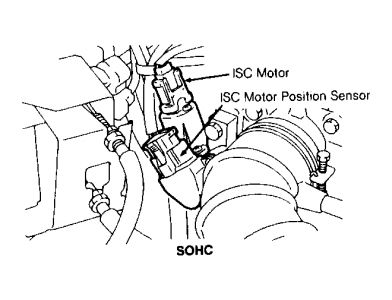

The IAC is located on the Intake near the throttle body. It looks like this.

Is this the IAC?
https://www.2carpros.com/forum/automotive_pictures/426570_jay4jpgth_1.jpg
-1
Sunday, November 1st, 2009 AT 9:34 PM
OBXAUTOMEDIC
  • 3,711 POSTS
Can't really tell. Here is a pic of the location...
And they call it an Idle Speed Control Motor (ISC) instead of a IAC...
https://www.2carpros.com/forum/automotive_pictures/188069_92galantiscmotor_1.jpg
