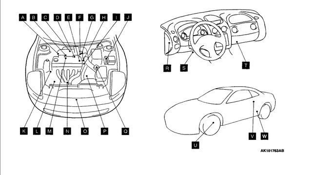

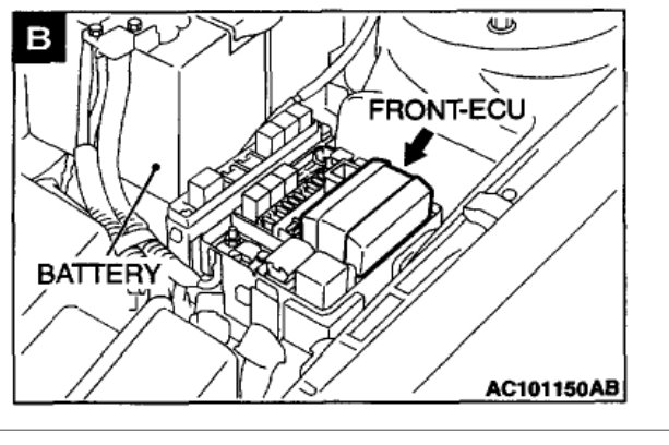

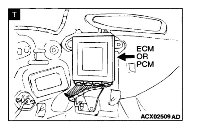

What happens is the coil driver for the #2 ignition coil is stuck on causing the coil to not work get hot and burn out. You must replace the ECM with a new or used unit to fix the problem.
Here is the ECM location you will need to have a shop program it for you.
