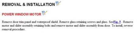

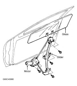

I need to replace my driver side window regulator / motor; I have previously replace the exterior door handle, which involved working around this contraption, I feel sure. I'd like detailed or illustrated instructions, if available; I've purchased the part but don't know [yet] if the instructions are included. I've been searching online, but...

https://images.2carpros.com/forum/automotive_pictures/261618_Noname_1358.jpg
FIG. 5
https://images.2carpros.com/forum/automotive_pictures/261618_Graphic_248.jpg
