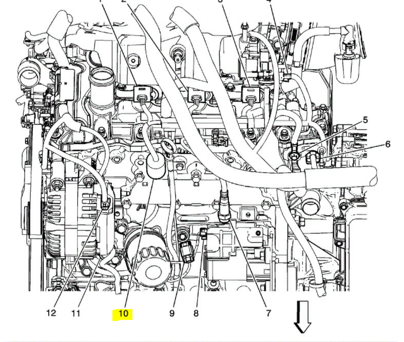

Misfiring since 6 months with RPM's fluctuations on cold start only. mechanic told me is due to oil leaking in cylinder, needs to change valve cover and sealing. how to confirm it (replaced spark plug, ignition coil, fuel injectors, previously)?
Dec 13, 2020 at 1:08 PM
  • 110,241 POSTS

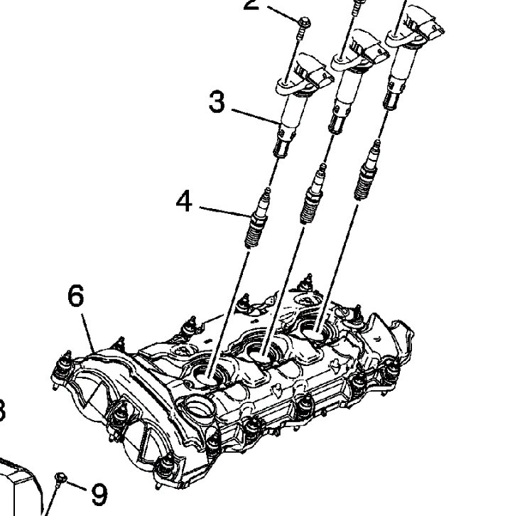

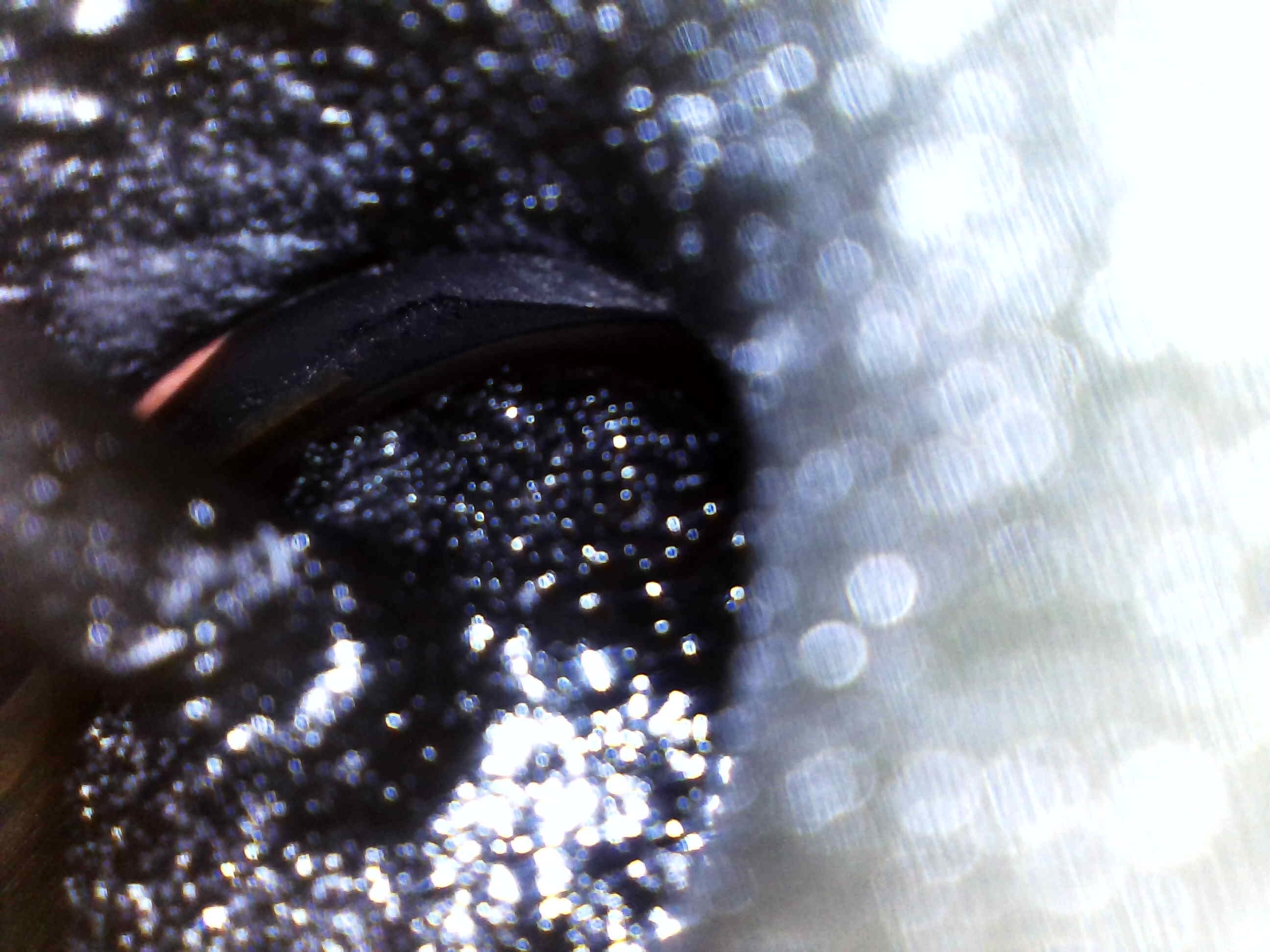

On this engine, each cylinder has its own ignition coil. What can happens is where the coils go down through the valve cover, there is a tube that has seals on it. If the seals fail, oil can then leak into the spark plug tube that the coil is mounted to. If that happens, it can cause a misfire by causing the rubber boot on the coil to fail and short.
The easiest thing to do is remove the coil packs and inspect for oil on them.

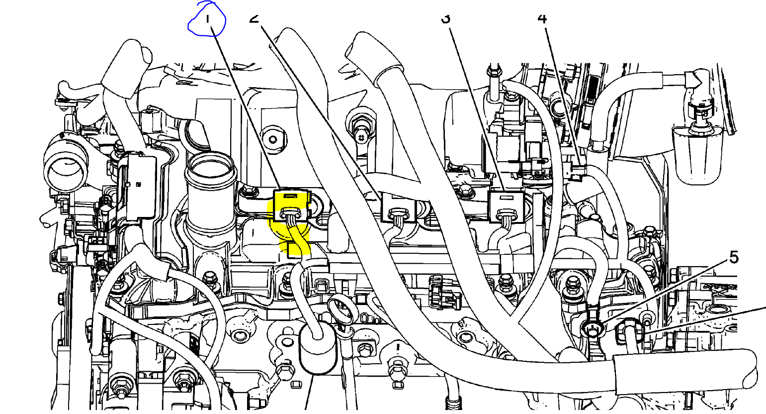

If you look at the attached pic, it shows where the coil goes down through the valve cover to connect to the spark plug. That is where I feel the leak may be located.
I noted that you indicated cylinder 3 (P0302) has the misfire. If you look at pic 2, I highlighted the number 2 coil pack. Facing the front of the vehicle, it will be on your right.
Let me know if you have other questions or need help.

Thanks for reply. i saw little oil in plug well.

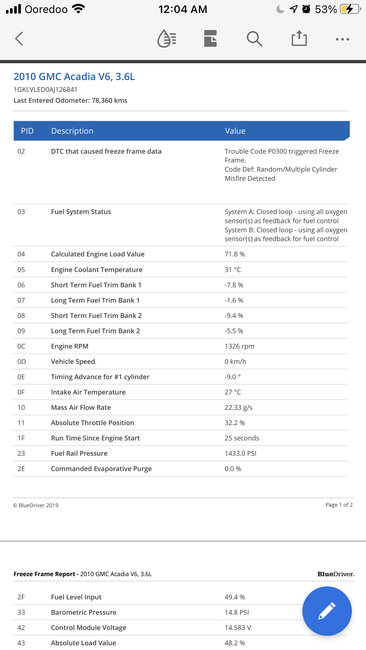

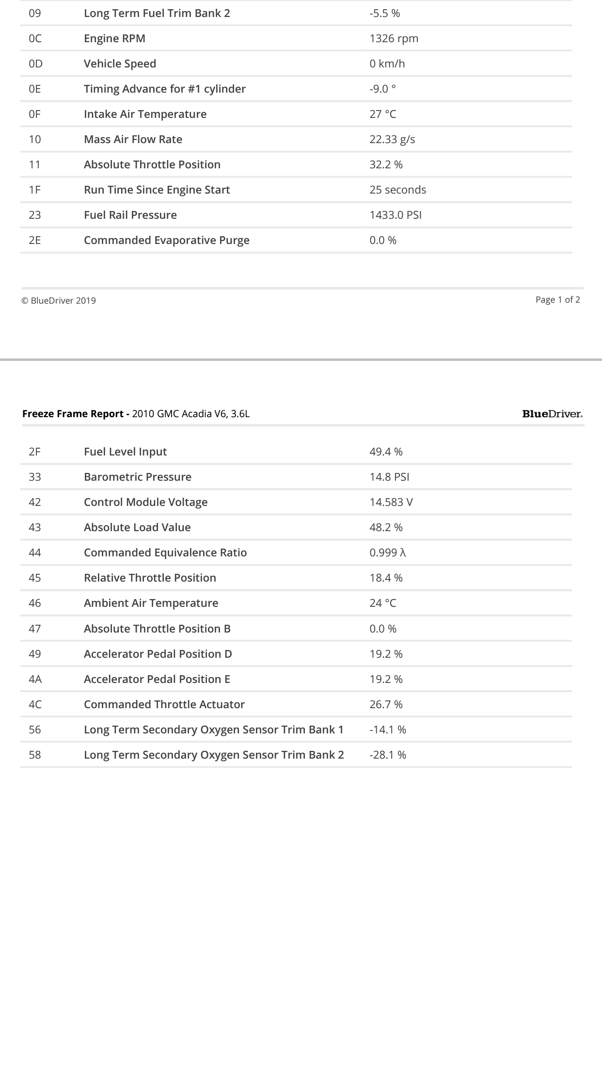

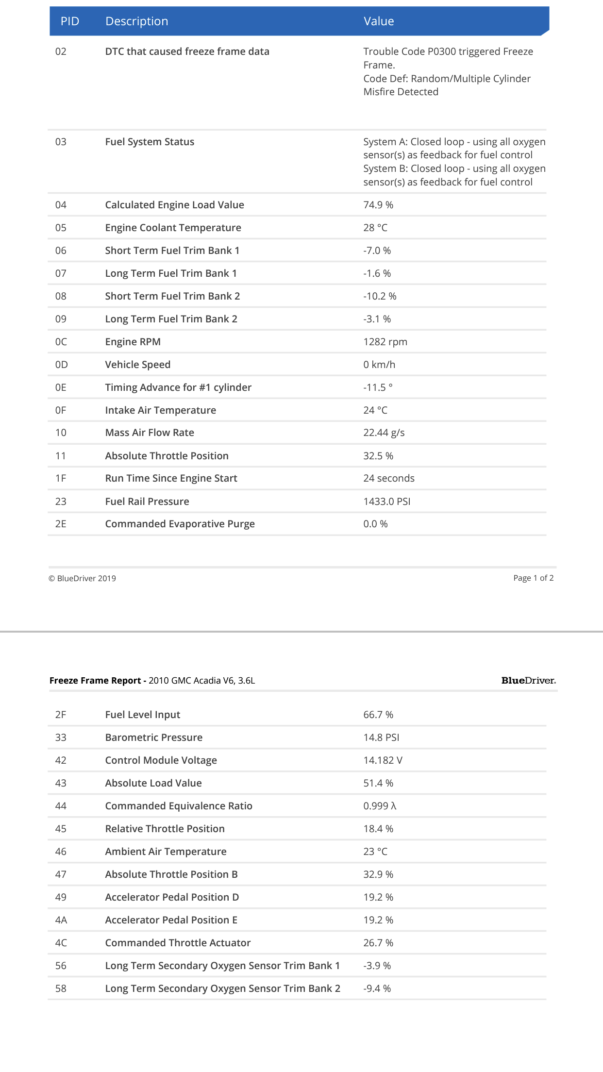

All spark plug tube seals are change with new spark plug on Monday, but today again check engine light came on with codes P302, P304 and P306. attaching freeze frame report if you see that coolant temperature 31 degrees C , and intake air temperature 25, Run time since engine start is 25 seconds.
Dec 16, 2020 at 5:10 AM
  • 110,241 POSTS
The fuel trims are a bit high (indicate the computer is removing fuel). But, they are not completely out of spec. I have a question. I'm not familiar with your scan tool. What is the fuel pressure?
The next thing I find of interest is that the new codes indicate misfires all on the same bank or side of the engine. It could be related to a fuel balance issue or pressure issue. Let me know if you have checked and what the pressure is in PS!. If I'm reading the scanner correctly, it's nearly 1500psi, which would blow the system apart. If you look at the attached pic, it shows what pressure should be.
Also, in your second pic, it shows long term fuel trims as really high. Bank 2 (where cylinders 2, 4' and 6 are located, it is excessive. The system is extremely rich. We need to check fuel pressure.
Follow the attached link above and let me know what you find.
Dec 16, 2020 at 6:03 AM

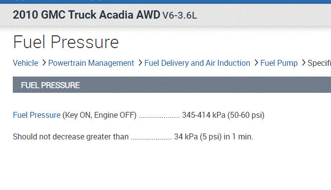

Thanks for input. this car is direct injection system so that having two fuel pressure system one is low pressure (fuel pump) and high pressure (seats on camshaft). so i have checked fuel pressure key on and engine of is 58-64 PSI.
Dec 16, 2020 at 12:30 PM
  • 110,241 POSTS
Okay, that is within spec. Did you try switching the coil from cylinder 2 with a different one to see if the misfire chances cylinders?

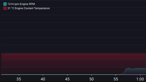

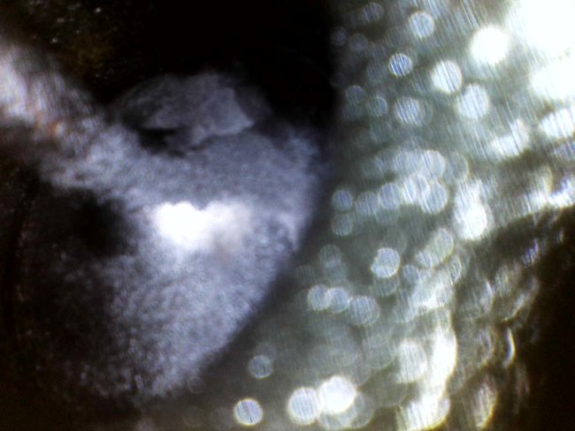

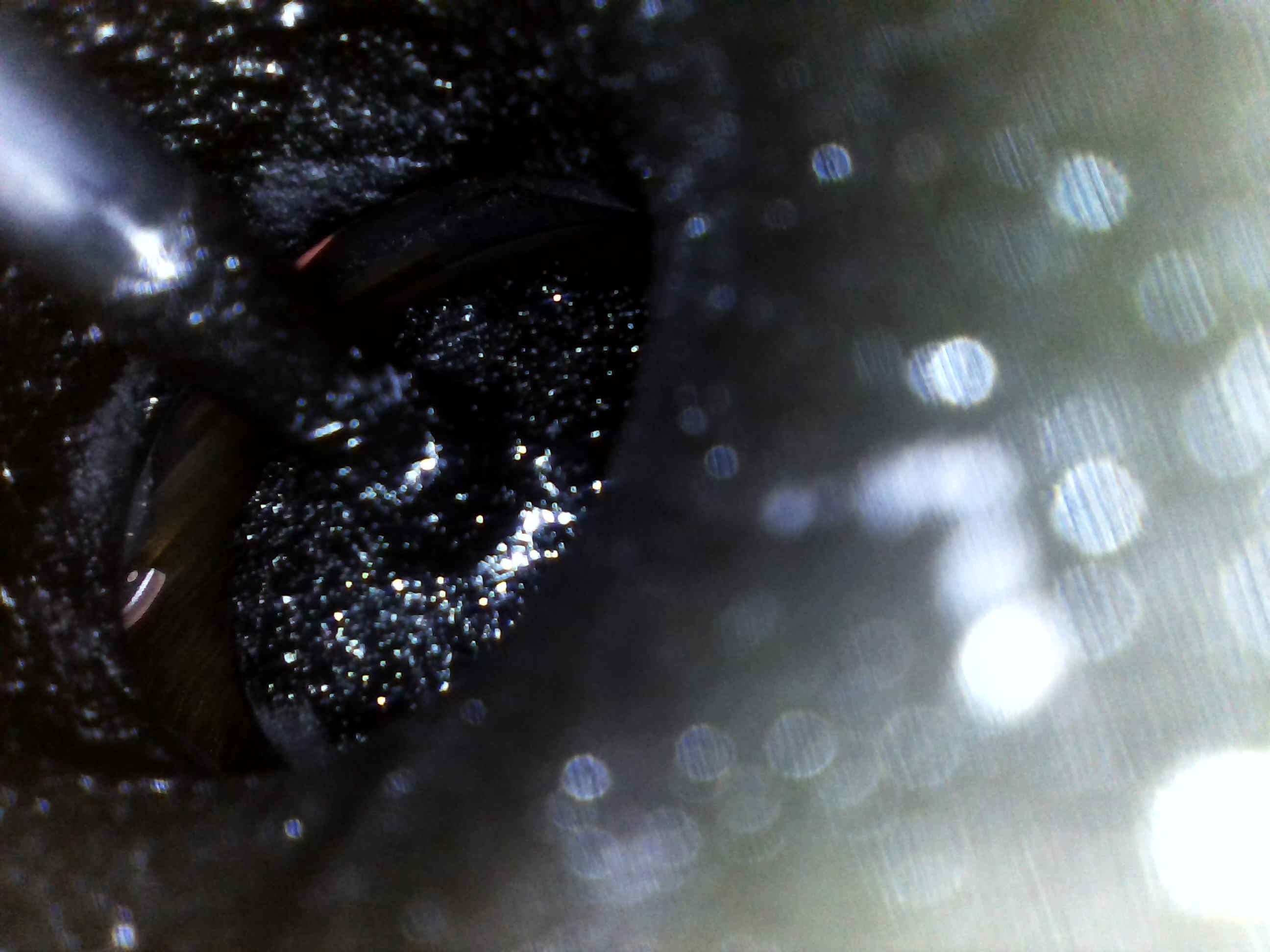

Hi, replaced the valve cover gasket and did the compression test for all cylinder was 140-150 PSI. Transmission can cause cold engine start misfire? and also found out the this attached image, is going to causes the misfiring.
Jan 1, 2021 at 11:53 AM
  • 110,241 POSTS
There is a lot of carbon. However, if that was causing the valve not to seal, it would have been evident with the compression test. I will tell you that 140 is what they indicate compression should not be lower than. Just for curiosity, were the cylinders at 140 the ones that have the misfire issue?
Also, and I may have already asked if you have a live data scan tool, have you checked the signal from the engine coolant temp sensor? (ECT see pic 1) Also, have you confirmed there are no engine vacuum leaks when it's cold?

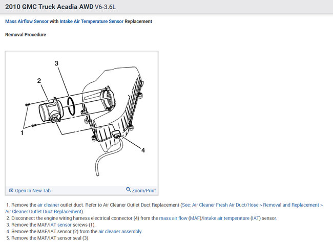

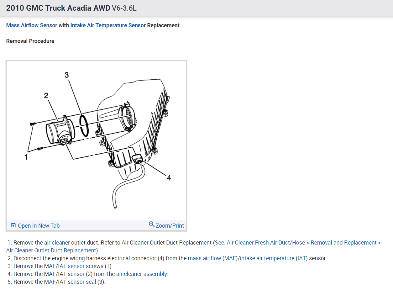

I have seen a bad MAF sensor cause the misfire issue without throwing a code, also I would service the throttle bore. Here is a guide to help you step by step with instructions in the diagrams below to show you how on your car:
https://www.2carpros.com/articles/how-to-replace-a-mass-air-flow-sensor-maf
and
After the work please clear the codes.
https://youtu.be/ahK_eucFi-k

Live data signal of coolant temperature sensor, if can notice the how the RPMs fluctuate

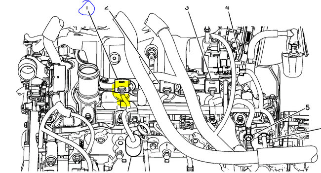

At cold start when misfiring and RPM fluctuations occurring the advance timing for cylinder number 1 is negative (retarded) 13-15 degrees , when the advanced timing becomes positive around 5-10 degrees the rpm stabilise. is it normal or its having issues of ignition timing?
