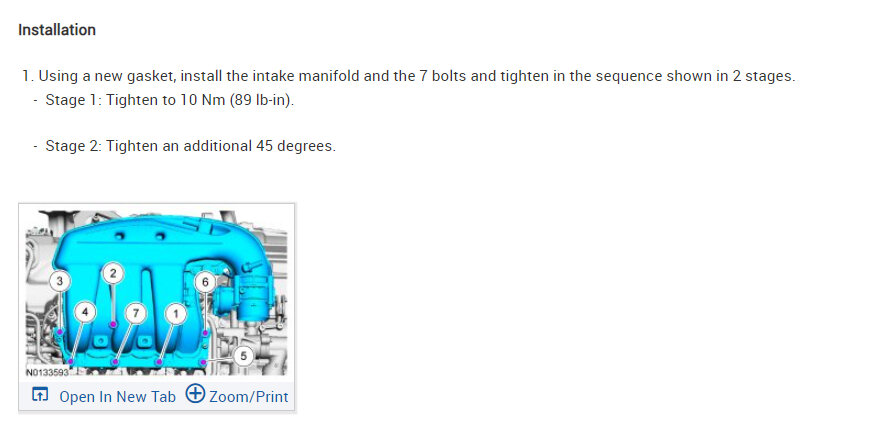

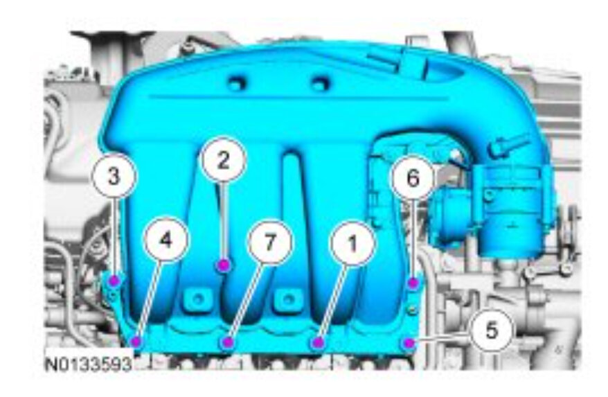

Oh okay, service info was incorrect on some of this. I would replace any intake gaskets as well if you're having to pull the upper intake off. And then retorque everything to spec. A vacuum leak on the back of the intake will cause a misfire on #3. Do you need the torque specs and sequence for the intake manifold bolts?
This is just like my truck; the number 3 is very difficult to get to.
Jan 10, 2024 at 3:42 PM
AL514
  • 5,587 POSTS
Here's the torque sequence and amount. Definitely put a new gasket on as well.

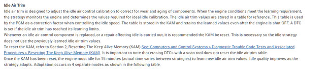

AL514
  • 5,587 POSTS

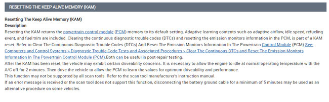

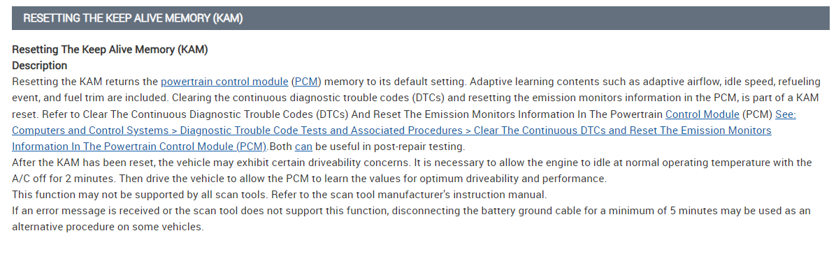

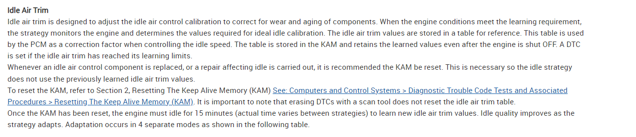

No problem, once you get the misfire squared away, its also good to reset the Keep Alive Memory of the PCM, so it will relearn its fuel strategy. But we'll go over that once the misfire is gone.

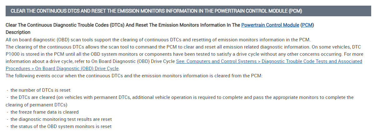

Okay, so far so good on no misfires after swapping out plug and coil. My O2 sensor voltage is fluctuating. Is keep alive memory reset where I put a resistor in between hot and ground cables.
Jan 10, 2024 at 5:46 PM
AL514
  • 5,587 POSTS

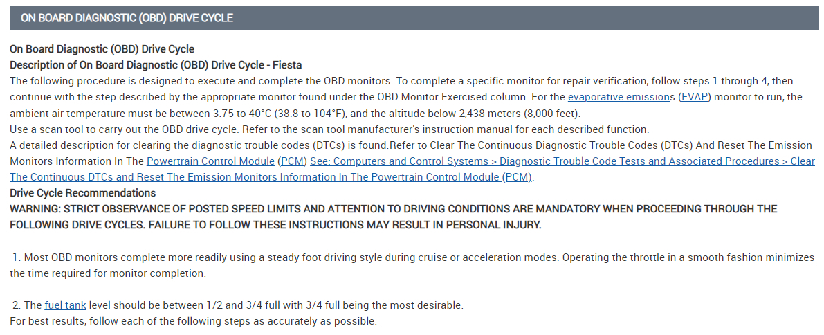

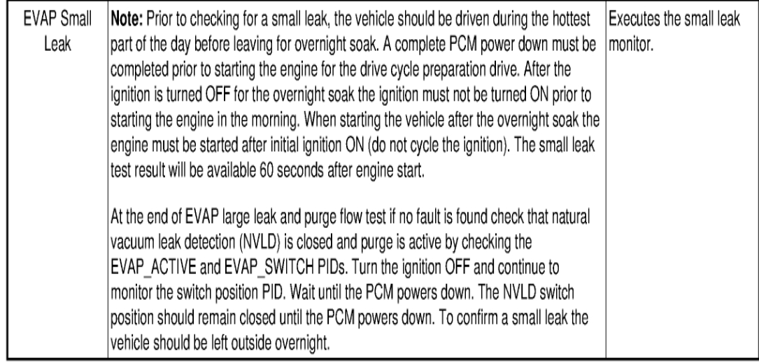

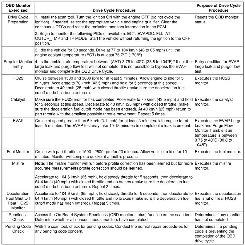

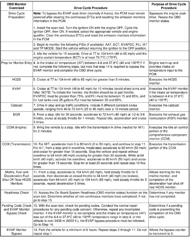

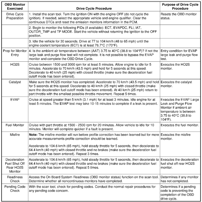

You should be able to reset the KAM with a scan tool. It will reset the Readiness Monitors as well; I'll post the info for that here really quick. First try erasing all codes and see if the Long Term and Short-Term fuel trims start out near zero%. If there's a code still stored, a continuous DTC like the p0420, the memory won't reset until that issue is cleared up. So, if that code is sticking around. I'd try a drive to get it hot and see if it will clear up. Sometimes they will sometimes not. It depends on how hot the cat got during the cylinder misfires. But here's the Readiness Monitor info as well, they need to be complete to get through inspection.

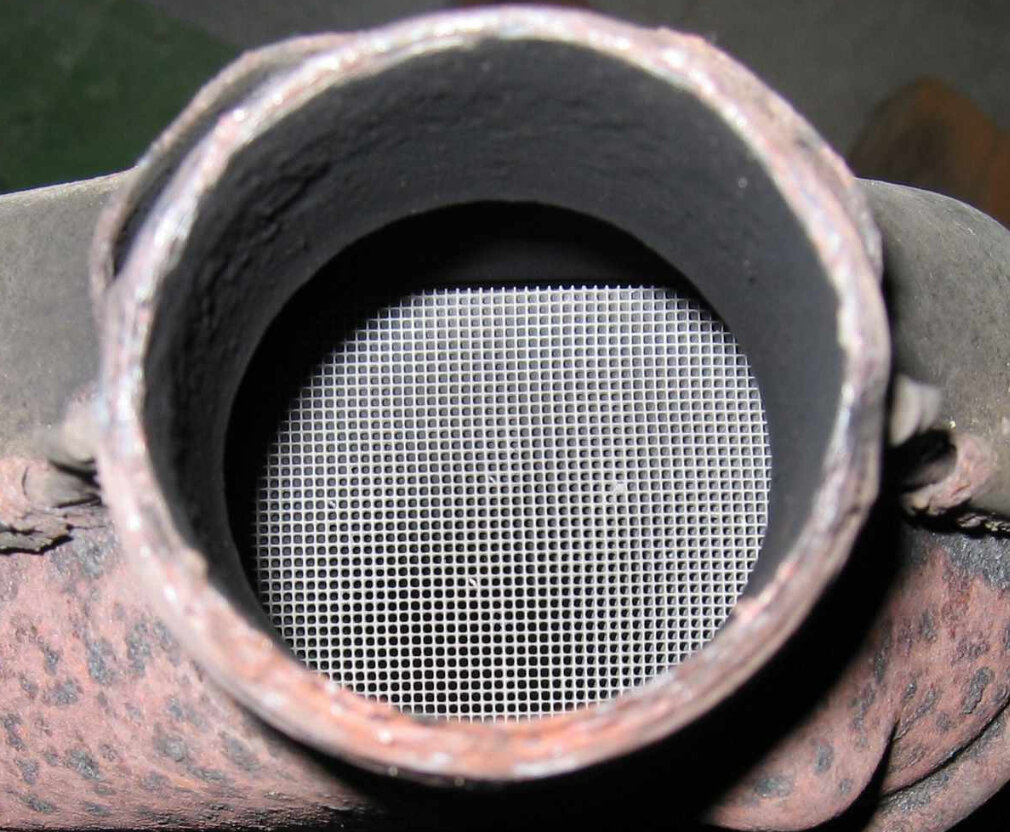

What I do with codes P0420 or P0430(bank 2) is visually inspect the cat with a borescope as well, or you can take the exhaust apart just to see what the front of the cat's substrate looks like. It should be a nice honey comb looking substrate. But if that Bank 1 is still rich for some reason, Fuel trims will tell you. The cats are supposed to be able to store oxygen to help them burn off the extra emissions gases. If its too rich and cant store oxygen, a P0420 will set.

Soap is not going to do anything, it's a matter of the condition of the cat on that side, they are made of precious metals such as Platinum, Rhodium and others that can break down the emissions gases into CO2 and water. So, in your case where there was unburned fuel entering the exhaust due to the misfires, that excessive fuel causes the cat to overheat and melt the substrate. hindering it from storing the oxygen it needs to burn off normal emissions.
There are Catalytic converter cleaners you can try, that are specifically made for that, although I have never tried any, because by the time a p0420 keeps setting the cat is usually done by then but you can try. Just google "catalytic converter cleaner" and you will see a bunch of different ones. But if you take down the exhaust and look into the front of the converter and the substrate is looking melted, where if you put a flashlight through the rear and can't see much light coming through the front, the cat won't last much longer.
When contaminants such as coolant from a leaking head gasket get into the cat, that's silicone and could potentially be cleaned out, but give it a try, take some pictures of the condition of the cat as well, I would be interested to know if any cleaners work.
