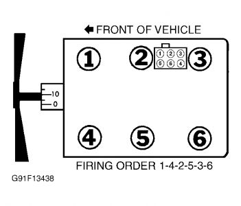

Where can I find a spark plug wire diagram for a 1996 ford explore? My husband changed the wires, but i'm not sure if he put them back right. Please help. Thank you Rosey
Monday, February 2nd, 2009 AT 2:24 PM
18 Replies
  • 110,176 POSTS
Hi:
Is the engine missing? If so, most likely they are wrong. I need to know if this has a 4.0L V6
Tuesday, February 3rd, 2009 AT 8:42 PM
ROSEYJOHNSON
  • 6 POSTS
Yes it seems like its missing and yes its a v6 4.O. Thanks Rosey
+1
Wednesday, February 4th, 2009 AT 1:17 AM
  • 110,176 POSTS
Rosey:
Here is the firing order and a picture of the engine cylender layout.
https://www.2carpros.com/forum/automotive_pictures/249084_firing_order_2.jpg

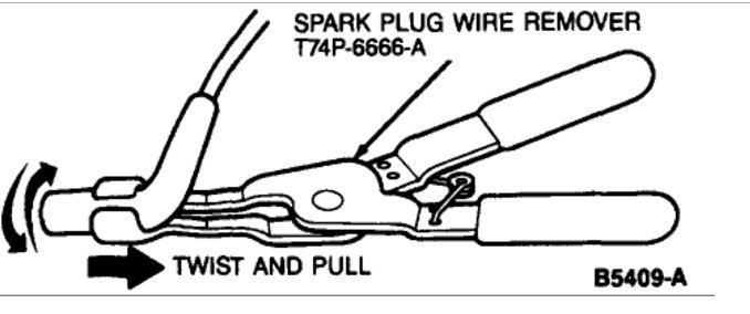

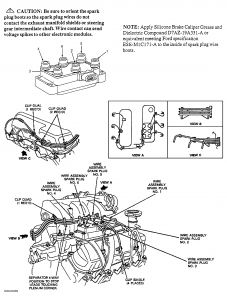

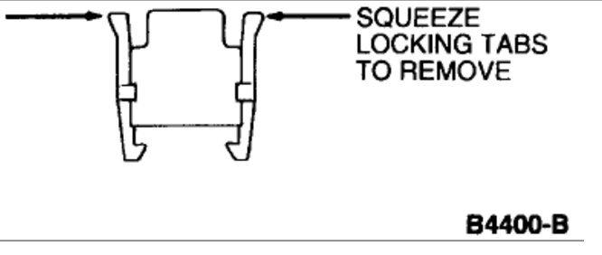

I need installing instructions on how to change all spark plugs and wires in detail.
Tuesday, May 16th, 2017 AT 12:15 PM (Merged)
KEN L
  • MASTER CERTIFIED MECHANIC
  • 54,325 POSTS
Here is a guide and some diagrams to help you get the job done.
https://www.2carpros.com/articles/how-to-change-spark-plugs
CAUTION: The Generator must be removed to allow for accessibility of the ignition wires that are routed below the generator.
CAUTION: Do not pull on the ignition wire directly as the wire may separate from the connector inside the boot.
Removing Ignition Wires At Coil Pack
REMOVAL
Disconnect ignition wire from spark plug by grasping the boot and twisting slightly in both directions to free it.
Disconnect the ignition wire from the ignition coil by squeezing the locking tabs and twisting while pulling upward.
Remove generator.
Open ignition wire separators and remove ignition wires.
CAUTION: Whenever an ignition wire is removed for any reason from a spark plug or ignition coil or a new ignition wire is installed, coat the entire interior surface of the boot with silicone dielectric compound with a "small clean tool" prior to installation.
CAUTION: Proper installation of ignition wires is critical to vehicle operation. If any ignition wire is improperly installed on spark plug or ignition coil, both spark plugs connected to that coil may not operate under load.
INSTALLATION
Install each ignition wire to the proper terminal on the ignition coils. The terminals on the ignition coils are numbered. Make sure the boots are fully seated and that both locking tabs are engaged.
Route ignition wire through ignition wire separators and close ignition wire separators.
Install generator.
NOTE: Ignition wire spark plug boot must be positioned 45 degrees from crankshaft centerline (outboard and forward) to make sure the boot seal is fully seated.

I replaced my spark plug wires and I gor them switched some how. I am not sure how to lay them in to get it running. Now it backfires. It was running better before I chamged the wires. How can I get the wires llaid beck in to the correct spark plugs?
Big dog
DAVE H
  • 13,384 POSTS
https://www.2carpros.com/forum/automotive_pictures/266999_wire2_1.jpg
https://www.2carpros.com/forum/automotive_pictures/266999_wire_3.jpg
+7

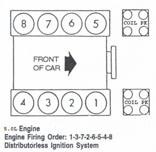

i changed my sparkplugs and the wires and the car was running ruff. Diagnostic said #6 missfire. Swaped the coil packs around car would not start. Put them back the same way and now car idle under 1000 and has gotten a bad hickup like a backfire in the front not so much at the tail. And have lost alot of power now. Oh also did not gap sparkplugs either, did not say it was required.
RICKMAR
  • 170 POSTS
When you put the coil packs
https://www.2carpros.com/forum/automotive_pictures/433905_coil_packs_1.jpg
back on, are you sure each ignition wire ( 1 3 7 2 6 5 4 8 ) is connected to the coil pack correctly?
https://www.2carpros.com/forum/automotive_pictures/433905_50L_firing_order_1.jpg
The spark plugs need to be gapped!!
(0.052-0.056 inch)
** If a spark plug is removed for inspection, it must be reinstalled in the same cylinder.
Cylinders No. 1, 2, 3 and 4 have a "EG" suffix. Cylinders No. 5, 6, 7 and 8 have a "E" suffix.
