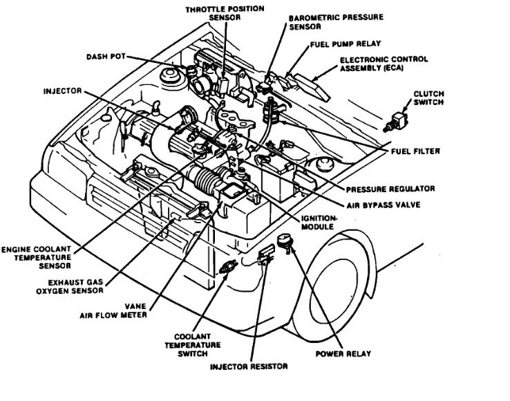

can you tell me where the fuel pump relay is located and also I have power on both sides of inertia switch but none to fuel pump.

The fuel pump relay is located under the hood near the fire wall on the passenger side.
Here is a diagram to show you
Please let me know if you need anything else to get the problem fixed.
Best, Ken

I had seen this posting prior to asking my question. However, this information is incorrect. I have completely taken apart the underside of the dash. It is not located where this diagram indicates. Please HELP!!!!

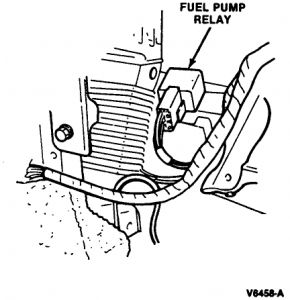

My tracer will not start after installing a new fuel pump and I cannot find where the fuel pump relay switch is located. Please help!

Under the dash at the top edge of the carpet.
https://www.2carpros.com/forum/automotive_pictures/561653_Fuel_pump_relay_89_Tracer_1.jpg
1. Disconnect battery ground cable.
2. Pull rearward on the front edges of the center carpet panel and disengage the push pin retainers.
3. Remove attaching screw and carpet panel.
4. Disconnect the relay electrical connector.
5. Remove relay retaining bolt and the relay.
6. Reverse procedure to install.

Wrong. Haven't found it yet, but it is NOT located where the above diagram shows it is.

They have this note with the location
FUEL PUMP RELAY (LESS A/C): Behind LH side of instrument panel.
FUEL PUMP RELAY (WITH A/C): Behind RH side of instrument panel.
