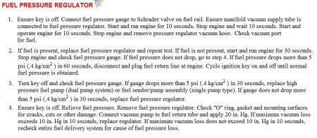

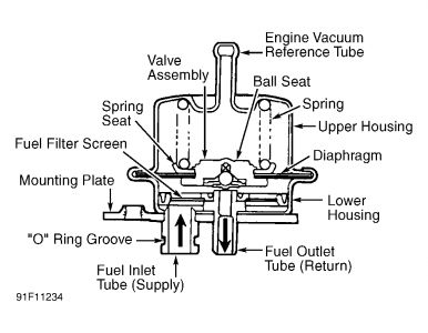

1991 Mercury Tracer low fuel pressure
1991 MERCURY TRACER
86,000 MILES • 4 CYL • AWD • AUTOMATIC
KASHEEDRA
we have replaced plugs wires air filter gas filter fuel pump and still only 30 lbs of pressure , what else can it be...help me please
