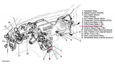

What happens to the power to the pump when the fan relay blows?
https://images.2carpros.com/forum/automotive_pictures/62217_93_Tracer_copy_1.jpg
With the relay in car, you should hear it click to energize!

The tracer has a "ccrm", or constant control relay module located underneath the air filter housing. It is basically a unit with three relays in one. It controls the engine cooling fan, the ac compressor and the fuel pump. It is possible for one "leg" of the unit to go out and the other two to work OK. I had that problem with my 99 tracer cause my ac compressor wouldn't run, but the other two things worked OK. I replaced it for $38 at a junkyard, now everything is AOK. That could be your problem. :-)
