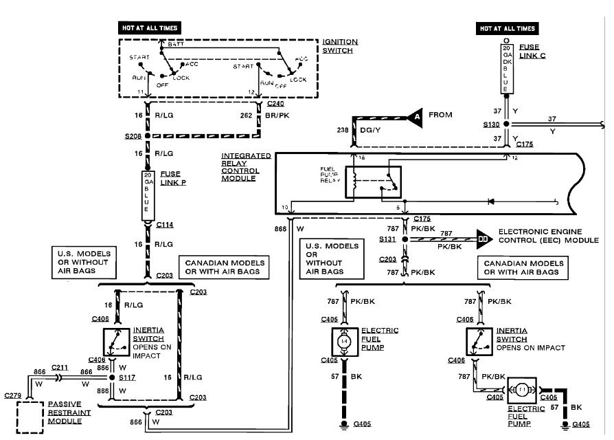

Where do you find the fuel pump relay and the fuel pump relay fuse on the Topaz, I bought this fuse and it looks like a little black box that supposed to plug into something but I don't know where it is????
May 31, 2009 at 5:09 PM
  • 54,840 POSTS
Hey TONY,
The relay is inside of the TICM here is a wiring diagram and a guide so you can do some testing and get the problem fixed.
Please let us know happens so it will help others.
Best, Ken

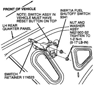

BOBBY RUSS
Electrical problem
1994 Mercury Topaz 4 cyl Front Wheel Drive Automatic 75000 miles
could you please tell me the exact location of the fuel pump relay switch with photo location
Feb 22, 2017 at 3:14 PM (Merged)
  • 75,992 POSTS
Wasn't sure which one you were referring too. INERTIA FUEL SHUTOFF SWITCH LOCATION Inertia Switch
https://images.2carpros.com/forum/automotive_pictures/12900_i_1.jpg
The Inertia Fuel Shutoff is located in the trunk, on the LH hinge support. FUEL PUMP RELAY LOCATION-Sorry no pic. Located in the Constant Control Relay Module (CCRM) at the LH side of engine compartment, near strut tower. https://www.2carpros.com/kpages/auto_repair_manuals_alldata.htm
