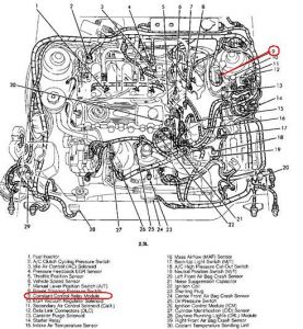

i need to find the fuel relay switch on my 94 topaz.. and i have NO clue where to find it..isnt it a little black box with a couple prongs inside??if thats it..where in the world would it be located.. i looked on several websites..but still no luck.. please help

Your vehicle's fuel pump is ran by the constant control relay module which is located in the engine bay, on the left strut tower, pictured below..
https://images.2carpros.com/forum/automotive_pictures/261618_Noname_337.jpg
