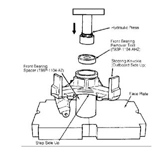

I'm replacing the driver's side wheel bearing on my 1992 Sable (145,000miles, 3.8L)
I'm not sure how much I need to remove> Should I take out the whole sterring knuckle? I'm not sure how to take it apart and what to take apart.

You can get a manual for specifics. https://www.2carpros.com/kpages/auto_repair_manuals.htm The spindle has to come out and the bearing needs to be pressed out and in.
https://images.2carpros.com/forum/automotive_pictures/30961_0wb_1.jpg

Thanks for the diagram etc about the wheel bearings on my Sable. I'm still having difficulty taking the assembly off to get to the point in the diagram. Do I also have to take the shock off as well as the steering knuckle assembly?

Spindle/knuckle..same thing. So that is a "yes"
