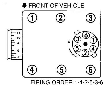

I replaced rotor, distributor cap, and the plug wires on my 1990 Mercury Sable, 3.0. Now it won't crank. So, I obviously screwed up the configuration by routing wires from the distrubutor cap to the wrong plug. Can anybody help me undo the mess that I've created? Please?

https://images.2carpros.com/forum/automotive_pictures/59481_1990_3_1.jpg
hows that for help , if you need more let me know jim thanks, jim oh and leave some feedback if you were happy with your help , we all donate our time here helping others
