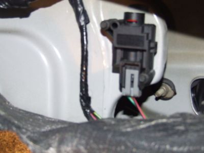

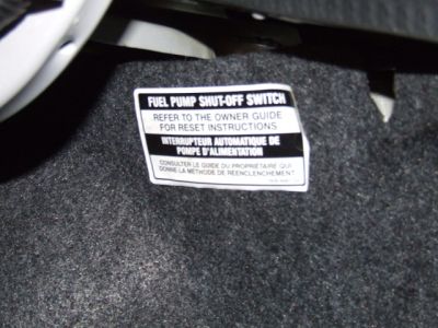

1998 Mercury Sable 97309 miles
Won't start - check engine light on. Trying to locate Fuel Pump Shut-off Switch. It is not where manual shows it.
Dec 14, 2007 at 9:44 AM
MERLIN2021
  • 17,250 POSTS
My mistake...it's halfway between the tail light and the hinge under the trim panel, here's a photo or two... the connector has a pink and black wire and green and yellow...The switch should be pressed down!
