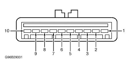

Ok now we are going to do a brake input test to the cruise module. First disconnect the harness from the cruise servo next to the master cylinder now check for voltage between a good ground and term number 9. If more then 10 volts then replace the servo as it is bad. If less then 10 volts then disconnect the deactivate switch at the brake pedal and check for voltage at the light green and red wire and gound (using you multi meter) if less then 10 volts then there is a short in that wire. If more then 10 volts then check the OHMs of resistance between the tan and orange wire at the brake pedal and the cruise servo term number 9 if less the 5 ohms then replace the brake switch if more 5 ohms then fix the short in the tan and orange wire. Here is a pic of the cruise control connector so you will know which term number is which. Let me know how it goes.
https://images.2carpros.com/forum/automotive_pictures/249564_Graphic_30.jpg

I definitely could've used a helper for this one.
On the Servo check, I could only muster about 1 volt or less, I was never sure it was connected as I had to use a paper clip to slide into the tiny slot of the harness.
So I moved on to the deactivate switch and found that to be at 10.5 volts. Which is good considering there is a break in the wires where i had to replace the old brake switch in order to get the taillights to work, and the Shifter to disengage.
I'm working on the OHM's test. A bit of a challenge as I can't hold the two leads without help, and it's after 9pm.

The wire showed .02 Ohms twice.
The first time I tried it, I used a paperclip to extend the inside of the connected from the servo, and it wildly fluctuated from -1 to 150, so I think the paperclip was to blame on that. After retesting twice I got .02 both times.
One thing to note, I had the car out of the garage, and went to put it in, and the shifter was very hard to remove from park. Thus the brake switch is to blame, and needs to be replaced just to get the car to work.
I replaced this before, but from the junkyard, guess sometimes things have to be bought new.

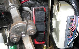

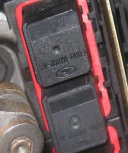

I do have another semi-related question for you. Under there, I found a bank of relays, that I can't find an explanation for. There are 4 slots, with 3 relays occupying 3 outta 4 slots, and it's got a cover upside down, but no idea what they are for.
Sometimes when the car doesn't start, I swear coming from there, is this rapid clicking sound. I get the feeling one of them isn't so swift, but I can't tell what they are for, as I disconnected them, and could still drive the car fine.

Can you include a pic of the relay's with the cover off but in the pic and tell me where this relay box is located and I will look to find what they do.

Had to shrink it down a lot, but this is a general idea. That metal thing is the steering knuckle.
https://images.2carpros.com/forum/automotive_pictures/180565_Relay_Close_1.jpg
https://images.2carpros.com/forum/automotive_pictures/180565_Relays_Closeup_1.jpg

It's all fun. Oh I found another 3 relays, on the outside by the battery box. Can't remove the cover though as you'd have to remove the battery box to undo the cover for it. Dumb, really dumb. Who thinks of these things?
Feb 9, 2009 at 5:46 AM
RACEFAN966
  • 5,029 POSTS
So these should be Door lock relay, Door unlock relay and flasher relay. Nothing to do with the running of the car. As for the bolts that broke I would anti seaze them unless there are in a water jacked area then I would use thread sealer.
