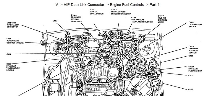

The vehicle speed sensor is lower right rear of engine. Could be other issues? Don't know why you can't communicate with computer?
+1
Monday, January 11th, 2021 AT 10:46 AM (Merged)
DAVIDG2006
  • 26 POSTS
Would the vss cause the black smoke out of tale pipe when reving the engine?
JDL
  • 16,098 POSTS
I don't know? Can effect shift patterns. Sounds like it is flooding, not sure why? How long since over-all tune-up?
DAVIDG2006
  • 26 POSTS
A month ago. Just changed plugs, wires, dist. Cap and rotor button
JDL
  • 16,098 POSTS
For the diagnostics, where did you hook-up?
DAVIDG2006
  • 26 POSTS
The ecc conection under the hood left side towards fire wall. Here's how I tried to jump it.
JDL
  • 16,098 POSTS
That hook-up looks good to me.
DAVIDG2006
  • 26 POSTS
It's still not showing me a code. When I hook it up this way the check engine light stays on. That's why I got my friends scanner and it still did'nt show anything.
JDL
  • 16,098 POSTS
There maybe a problem with your computer, or the wiring circuit?
DAVIDG2006
  • 26 POSTS
How do I check that?
JDL
  • 16,098 POSTS
Check voltage and grounds at the computer. My pin-outs show the sti connector to have 5 volts on it?
DAVIDG2006
  • 26 POSTS
Sorry i'm not sure what you meen about pin-outs or sti. Where is the computer located on that car?
JDL
  • 16,098 POSTS
The sti is in your diagram. For the 3.0 the computer is under the hood, passenger side, close to firewall.
DAVIDG2006
  • 26 POSTS
Thank you, by the time I got to your response it got dark. I'll have to check it tomorrow. With no light it's a little difficult.
Monday, January 11th, 2021 AT 10:47 AM (Merged)
JDL
  • 16,098 POSTS
I understand. Let us know.
