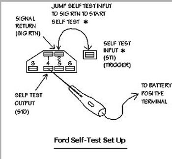

I have a check engine light on, not all the time. When it is on the transmission is not shifting right. I can only get up to 45mph at 3000rpm. What can this be?

The first thing I need from you is the exact codes your computer has that is are starting point.
Monday, January 11th, 2021 AT 10:46 AM (Merged)
DAVIDG2006
  • 26 POSTS
I've tried to pull the code and it wont show. I did it by jumping the eec under the hood like it showed me on the computer and the light goes off.
SATURNTECH9
  • 30,869 POSTS
Have you tried a analog volt meter instead of watch the light?Meaning a volt meter with a needle not digital.
DAVIDG2006
  • 26 POSTS
No I don't have one of those. The attached image is how I did it. I used a jumper wire instead of a test light.
SATURNTECH9
  • 30,869 POSTS
Looks like. Your going to have to try a different way or you may to just get a scanner that will read your car. If the lights coming on and its acting up we need to start with what codes it has.
DAVIDG2006
  • 26 POSTS
What kind of different way that I can try because I don't have a scanner, and I've been trying to pull the code all day, I know the code is what I need. I really need to get this car going because it's my only way to work. It started doing this yesterday. Thank you for your help.

SATURNTECH9
  • 30,869 POSTS
Here are the ways I have listed to retrive codes analog volt meter scanner check engine light and star series tester.

Your welcome keep me posted best thing you could get is a obd1 scanner that would work on your car.

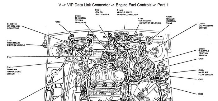

I also have a 1995 Mercury Sable that I'm desperatley trying to get back on the road. I got insurance and tag on it and broke the next day. Check engine light comes on after running a few minutes and runs bad with black smoke coming out of tail pipe. It seems like it's not shifting right. It will only do 45mph at 3000rpms. I tried to pull the code with a friends scanner and it wont pull. I've tried jumping the eec and using the scanner. My friends scanner is a snap on with right adaptor and computer card.

Maybe a problem with vss, vehicle speed sensor. I'll find a diagram.
