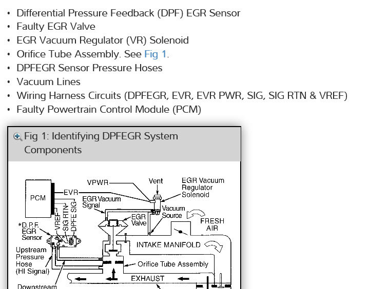

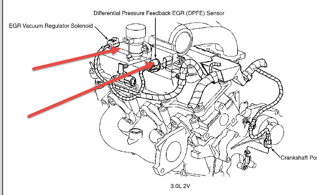

My engine light is on and when the code was checked it said it was a P1400 code. I am wondering if you could help me locate the part that needs to be replaces and what area it is in and what I am looking for? Thanks in advance for any help you can give.
May 2, 2016 at 7:18 AM
HMAC300
  • 48,601 POSTS
could be either item in pic as well as egr valve or partially blocked egr lines a broken vacuum line etc.
