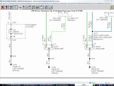

I have a 98 Mountaineer 2wd v8 engine 178k miles. My headlights recently started working intermitently and now they dont work at all. I can flash my bights but that is all. I have tried replacing the bulbs and have checked all the fuses and have had no luck.
Any help would be great!

Check fuse # 11 in the fuse box, and fuses # 11 and 12 in the power distrbution box on the right front of the engine compartment, if all are good check for a loose ground wire, here are the ground locations.
https://images.2carpros.com/forum/automotive_pictures/62217_Grounds_1.jpg
If that doesnt work you will need to test the autolamp relay, if it has autolamps, and the mulifunction switch on the column...
