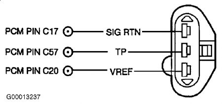

I have a fast idle now almost daily and with it the engine stumbles while driving. They always occur together.
Out of frustration I unplugged the MAF while under fast idle. The engine really didn’t change. I plugged it back in and unplugged the TPS. The engine idled down nicely. When I reconnected it, the engine went back to a fast idle. I did this several times. The fast idle always came back the TPS was reconnected.
Does this indicate a TPS problem?

It could be, but the MAF and tps are tied to injector pulse width, if the maf was dirty, I suspect that, or the PCV rubber elbow has a crack or rotted out a bit. Test TPS like this: 9) Check Voltage Between VREF & SIG RTN Circuits At TP Sensor Using a DVOM, measure voltage between VREF and SIG RTN circuits at TP sensor harness connector. See Fig. 38-Fig. 42 . If voltage is 4-6 volts, replace TP sensor. If voltage is not 4-6 volts, reconnect components and go to TEST C, step 1). 10) Check TP Circuit For Short To VREF Or VPWR Circuits Turn ignition switch to OFF position. Leave TP sensor disconnected. Disconnect PCM connector(s). Inspect connector for loose, damaged or corroded terminals and repair as necessary. Using a DVOM, measure resistance between TP circuit, VPWR and VREF circuits at PCM harness connector (both VREF circuits on 150-pin PCM). Both VREF circuits on 150- pin PCM models. If any resistance measurement is 10 k/ohms or less, repair short between circuits. If all resistance measurements are more than 10 k/ohms, replace PCM.
https://images.2carpros.com/forum/automotive_pictures/62217_TPS_4.jpg

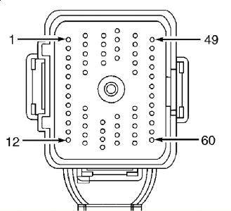

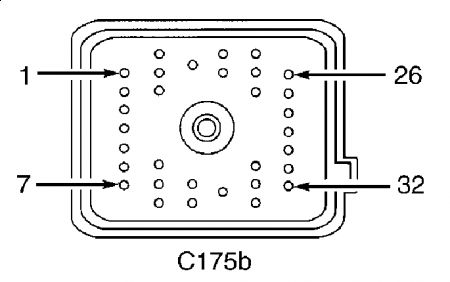

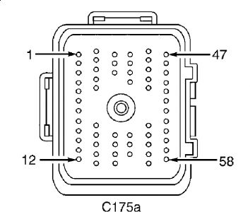

Pcm connectors are shown below.
https://images.2carpros.com/forum/automotive_pictures/62217_pcma_1.jpg
https://images.2carpros.com/forum/automotive_pictures/62217_pcmb_1.jpg
https://images.2carpros.com/forum/automotive_pictures/62217_pcmc_1.jpg

The voltage between the Vref & Sig Rtn is 4.9V & between Vref & TP is 4.7V. The voltage was measured with the TPS unplugged and engine running at slow idle. Am I suppose to measure the voltage with the sensor connected to the PCM and engine running?
Jun 28, 2009 at 4:12 PM
MERLIN2021
  • 17,250 POSTS
Yes but be careful not to ground the wires, use a pin to penetrate the wires. Alternate method is to unplug the TPS with engine off, measure resistance, as you move the throttle, the needle should sweep smoothly, no sudden jerks, have you replaced the MAF?

The TPS resistance was jerky between Vref and Signal Rtn & the sensor read 4.9V while the engine was running.
I plan to replace the TPS tomorrow (if in stock) & go from there.

Brandon go to Rock auto.com and look for the ford unit, I dont use refurb when it comes to MAF. Let me know. If TPS was jerking the needle, it should go!
Jun 29, 2009 at 4:06 PM
BLUKE
  • 11 POSTS
Merlin,
I replaced the TPS last night and the engine runs much better. The fast idle is gone and the engine ran well the couple miles I test drove it last night.
