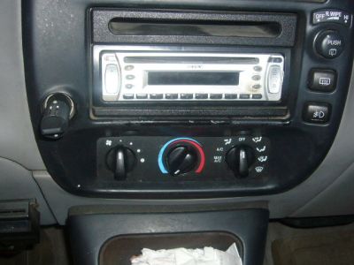

Auto temp control, or manual?
Tuesday, July 21st, 2020 AT 11:58 AM (Merged)
CHILLINS

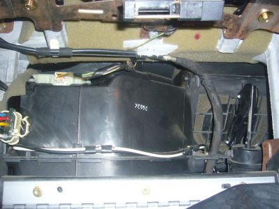

I assume the auto temp control is digital read out. here is a pic of my dash and behind the dash.

MERLIN2021
  • 17,250 POSTS
Sounds like the heat control valve on the heater water inlet hose, test this way.
