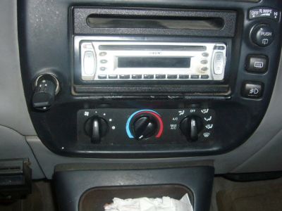

Auto temp control, or manual?

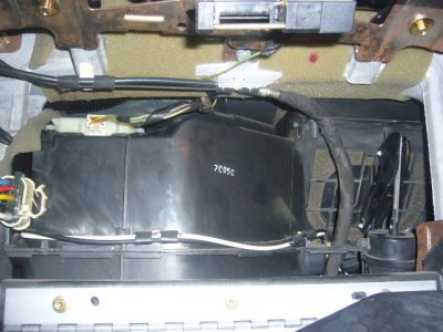

i assume the auto temp control is digital read out. here is a pic of my dash and behind the dash.

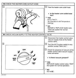

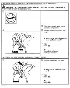

Sounds like the heat control valve on the heater water inlet hose, test this way.

it does not do it constintly. when the car is stopped at a light you can barely feel any air. but when you are driving down the street then it blows out stronger.
