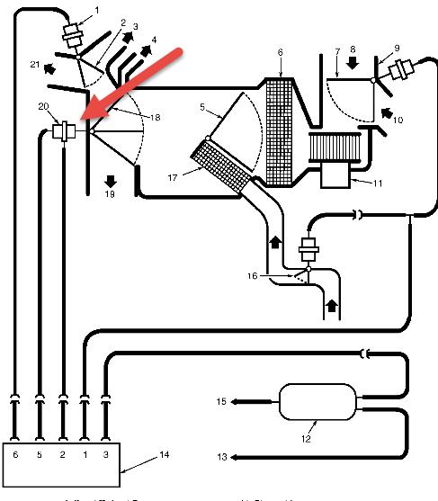

With the engine at full operating temp, locate the 2 heater hoses where they go into the firewall and feel them to see if they are both hot to the touch. If they are..........
The temperature is controlled by the use of an air mix door that is operated by an electric motor/actuator. This door can be jammed or the actuator can be inoperative or have stripped plastic gears internally.

First, is the engine warming to a normal operating temp? Second, with the engine running, hot, and the heat on, feel both heater core hoses. They should both be hot. Finally, is the coolant level full?
Let me know what you find. IF these things are all ok, we will need to look at the blender door.

It sounds like the blend door is stuck. It is what determines if you get AC or heat. It is under the dash and half of the dash needs to be removed to access it. That is my first guess based on your discription.

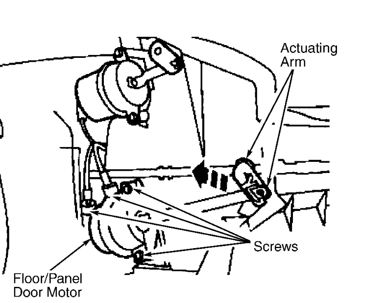

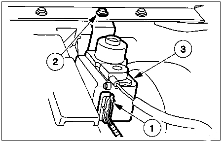

When your blower motor was working in only one speed "High". It is very possible your blower motor resistor is either stuck or needs replacement. If you can repair it yourself that will save you some money. Here is what you need to do. Remove the speed control servo. Disconnect the electrical connector.(1) Remove the bolt. (2) Position the speed control servo (3) aside.
https://images.2carpros.com/forum/automotive_pictures/433905_Servo_Motor_1.jpg

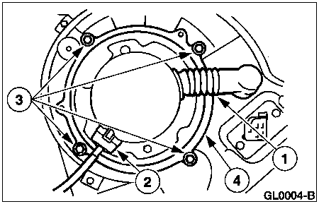

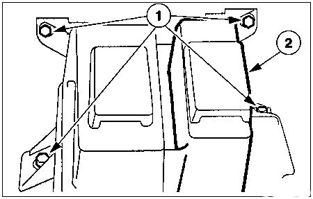

Remove the coolant/washer reservoir. Remove the two screws and the two nuts. (1) Move the coolant/washer reservoir (2) aside.
https://images.2carpros.com/forum/automotive_pictures/433905_Windshield_washer_res_1.jpg

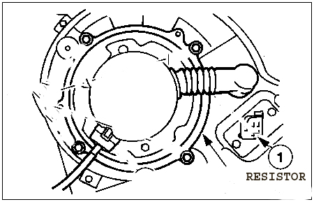

Refer to the sketch below for the blower motor resistor location. You will see the blower motor resistor (1) just below the vent hose. The arrow is pointing at the blower motor housing. Turn the heater fan speed selector on "High". Turn the ignition "On" but do not start the engine. Get a long screwdriver or something similar and place it against the resistor housing. Give the resistor a slight tap, listen to see if the blower motor is working. If it isn't, give it another tap.If it is not working, give it one final tap. If the blower motor is still not working the resistor needs to be replaced. To remove the resistor: Disconnect the electrical connector from the resistor. Remove the two small bolts. Remove the resistor and replace it with a good one. You can buy the resistor "new" at an automotive parts store or if you have a "Junk Yard" or "Auto Salvage Yard" near you, you can pick a used resistor up from them and save some money
https://images.2carpros.com/forum/automotive_pictures/433905_Blower_motor_resistor_copy_1.jpg
I hope that helped you out; Rick
