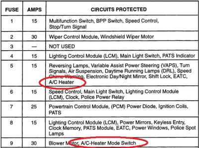

Both fuses blow sometime. Fuse 5 and fuse 9. Cannot keep turn signal fuse replacing and I need the airconditioning blower etc to come on. How are the two related in the wiring diagram What is my problem, worked fine the last 100000 miles. I have replaced fuses and tried to find shorted wires but to no avail. Need some expertise on how to approach it.

That is how #5 and #9 connected. Start checking for frayed/shorted wire behind the AC control panel.

Thanks for the info. I will try that. The Owners guide ON PAGE 123 DOES NOT SHOW LIKE YOURS. Worded differently only slightly but does not show the AC /Blower Motor in the list. Thanks will let you know in a few days. Next day I am off work to chase it down.
