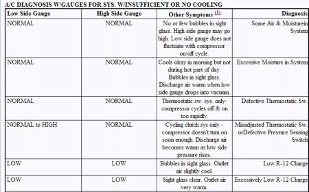

I have a 1992 300D. When the a/c works it cools the car beautifully. However after driving for a short or long distance it seems like the compressor just quits. If I turn off the ignition and restart the car the a/c comes back on. Any thoughts please?

Check the evaporator for a temp sensor, sounds like the core is icing up.

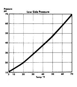

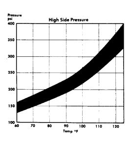

Additional info, If you have manifold gauge set take readings and post here! The reason is the sensor shuts it down, we aren't talking about a block of ice, only mild icing...could be other issues too, need readings if you can...I will look into it further in the am!

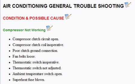

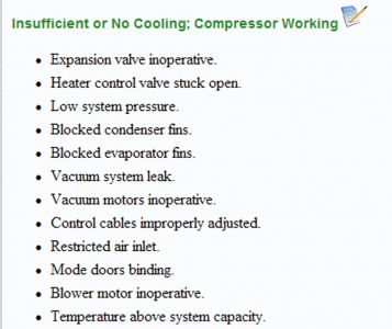

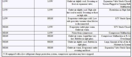

Here are the testing proceedures, see if they help...It would be real good if you know about using the manifold gauges!
