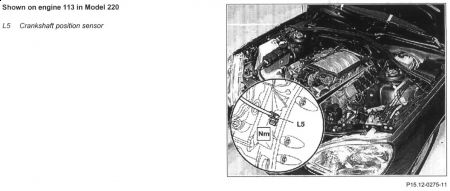

1999 Mercedes Benz ML430 V8 Four Wheel Drive Automatic
ML430 starts then dies and will not start until 15mins later
sometimes I can drive 60miles no prob
sometimes only 1mile then it dies, have to wait then restart
I can hear the starter
new battery and alternator
I changed new sparkplugs but same problem
Tuesday, June 16th, 2009 AT 12:37 AM
STEVEW84
  • 673 POSTS
Probably needs a crankshaft position sensor. Very common failure item. Here is the location of it. Only get the part from the dealer.
https://www.2carpros.com/forum/automotive_pictures/170495_ckp_2.jpg
