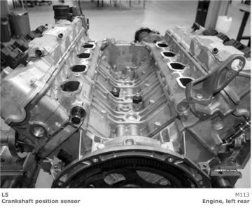

How do you locate and change the crank position sensor?
Jul 1, 2010 at 12:38 PM
  • 75,992 POSTS
Location of the crankshaft position sensor:
https://images.2carpros.com/forum/automotive_pictures/12900_c_4.jpg

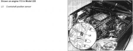

Remove/Install Crankshaft Position Sensor Shown On Engine 113 In Model 220
https://images.2carpros.com/forum/automotive_pictures/12900_c1_34.jpg
Work Instructions NOTE: Remove Air cleaner (engine side). Crankshaft position sensor to engine block - 8 N.m NOTE: If the crankshaft position sensor (L5) was replaced, a re-initialization must be carried out with STAR DIAGNOSIS in the menu item control module adaptations. https://www.2carpros.com/kpages/auto_repair_manuals_alldata.htm
