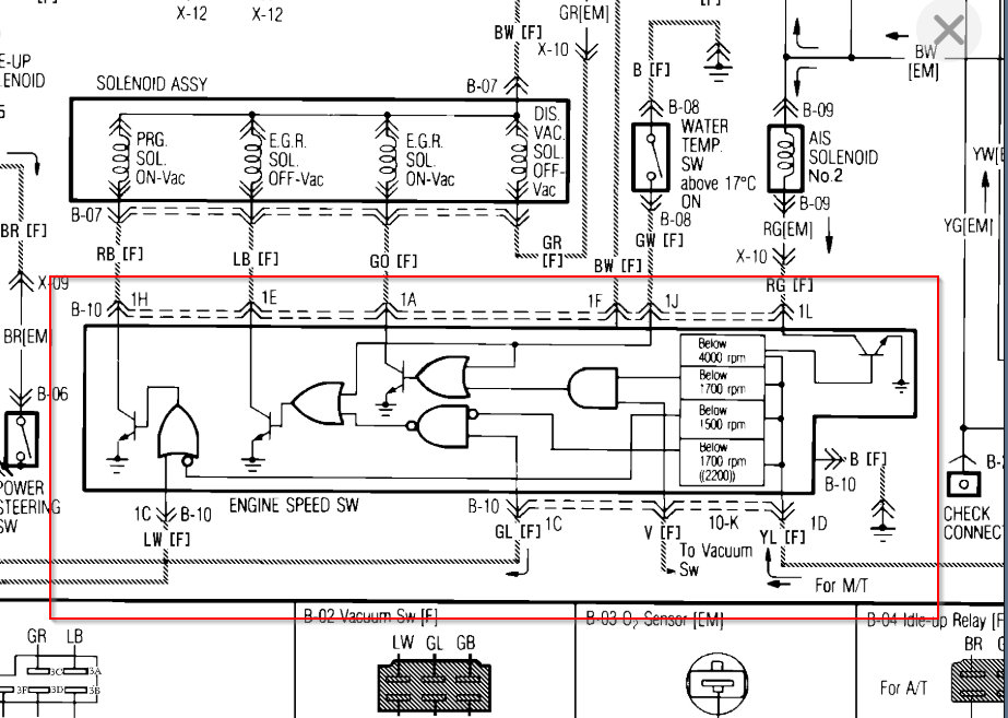

I have a 1986 Mazda B2000 and an 1987 B2200. Both trucks have been modified with Weber 2bbl carburetors and header exhaust.The 1986 had approximately 120,000 on the engine when mods made. Mileage went up to 27-30 mpg at 70 mph and top speed to 97 mph. 1987 truck had mods made when engine was rebuilt. with 20,000 on new engine, mileage remains around 23 mpg. Top end is about 83 mph, and truck will not surpass 4,000 rpm in fifth gear. why such a difference? Annoying as the 1987 is the one I've sunk the restoration money into.

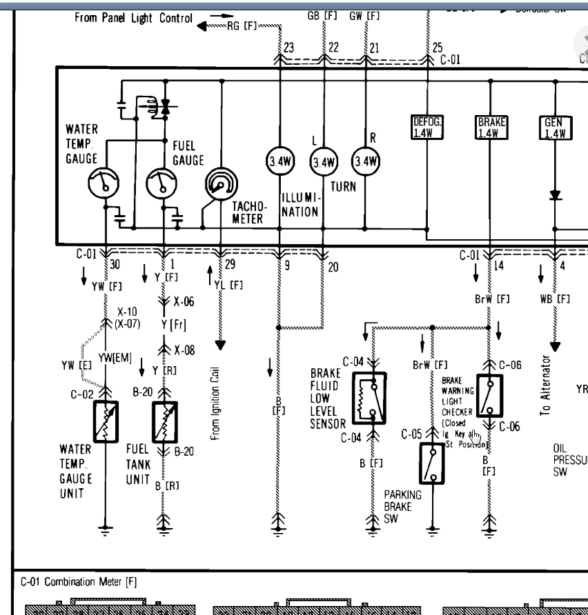

First of all, are you looking at the gauges when you say that it won't go above 4000 in 5th gear? If you are, that's a mistake. You may not believe it, but the tachometer is somehow linked to your truck's vacuum system. Secondly, the Mazda b-series truck's numbers actually refer to the size of the engine up until the late 1990's(b2000 had the 2.0, b2200 had the 2.2 and so on) Have the vacuum and emissions controls re-installed, checking for gravel or dead bug parts in the vacuum pots and such. After they are replaced, watch the tachometer when you start the truck and rev it at idle
. You should see a difference.

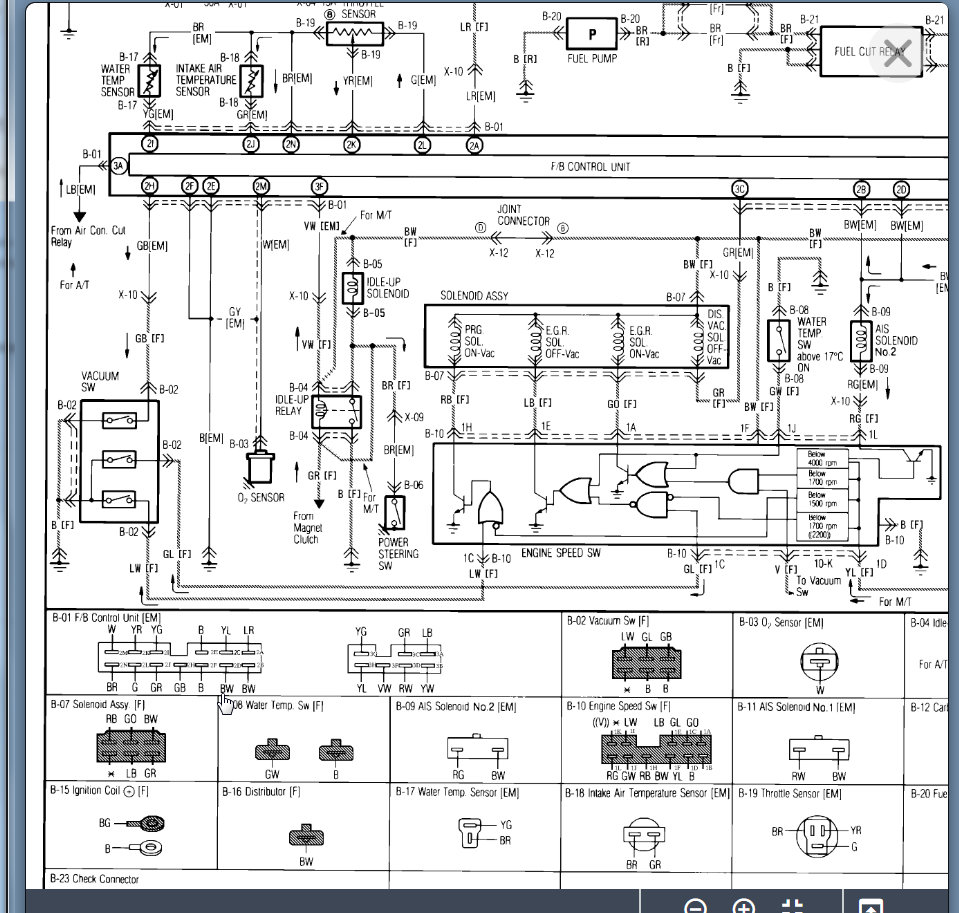

My first thought is the carburetor itself. You may have different jets in the carburetor that allow less fuel than the other carburetor.
As far as the mileage goes, depends on the cam, timing and the rest of the truck such as transmission and differential ratios.
Mar 26, 2020 at 1:06 AM
The tachometer is "related" to the engine vacuum system but it is not dependent on the engine vacuum to operate the gauge. The ignition system has what is called an engine speed switch. It takes inputs from the vacuum system and converts that to an electrical signal and sends that to the cluster. So if the gauge is not going over 4,000 RPM's then we need to look the engine vacuum itself and not the tachometer. This would mean we need to put a vacuum gauge on the engine and see what it is doing when the RPM's are high in other gears and then what it is doing in 5th gear. There should be not much difference because the engine doesn't know what gear it is in so the vacuum should be similar in each gear.
I am leaning towards a carburetor issue.
Please reach out with questions.
