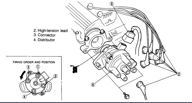

1993 DOHC. Read the codes and came up with #3 distributor g-signal. I have already change spark plugs, wires and distributor rotor, and cap but still get code. Can someone help me at what to look at and what is a g-signal? Thanks, wagsjl

I thing g- signal is a rpm or cam signal from distributor to the ECM. Either an input or acknowledgement signal to the computer.

Good evening,
The ECM is not seeing a signal from the distributor for engine RPM. When this happens, the ECM will not allow spark or fuel.
You need a new distributor.
What usually happens is oil gets inside the distributor and the parts inside short out.
