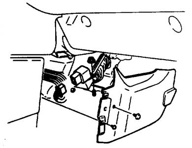

So all this checked . However when key is turned to the on position we have no fuel pressure and pump doesn’t work

https://images.2carpros.com/forum/automotive_pictures/12900_fpr_27.jpg
Remove passenger side center cover. Unplug relay connector. Remove relay from PCME bracket. Install in reverse order of removal.
