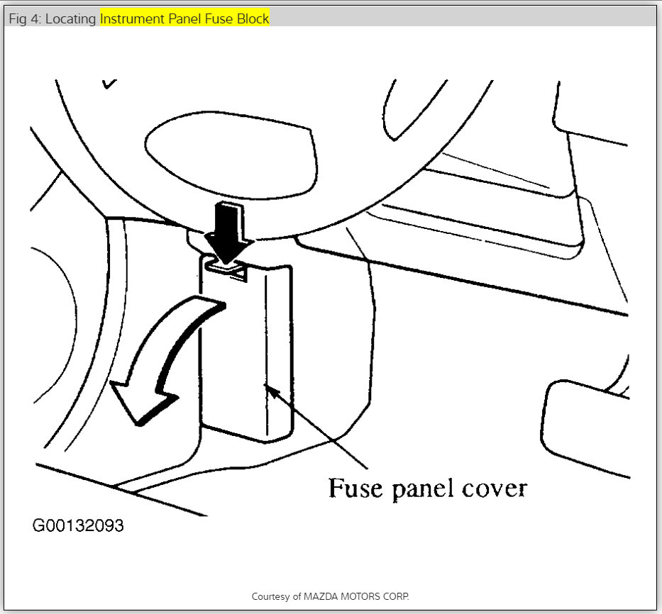

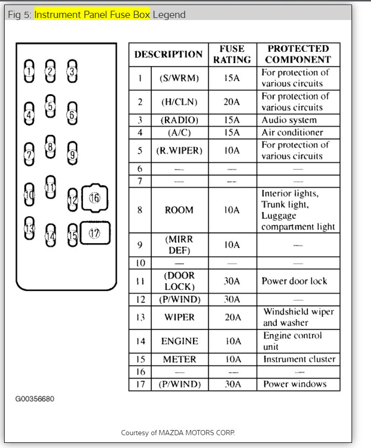

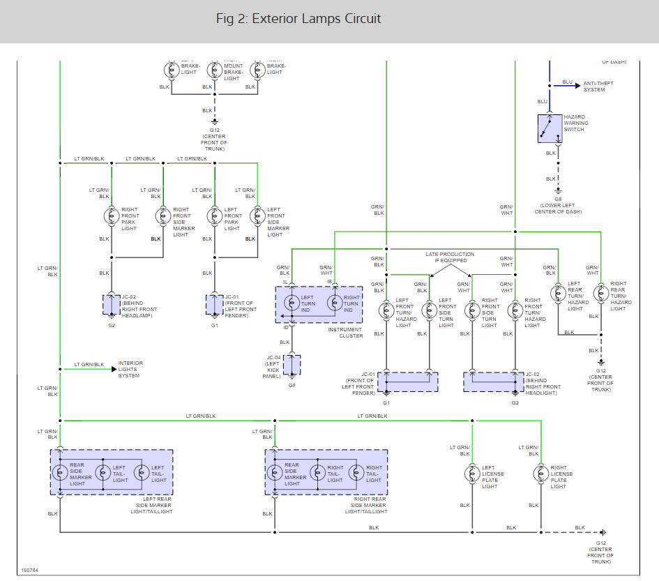

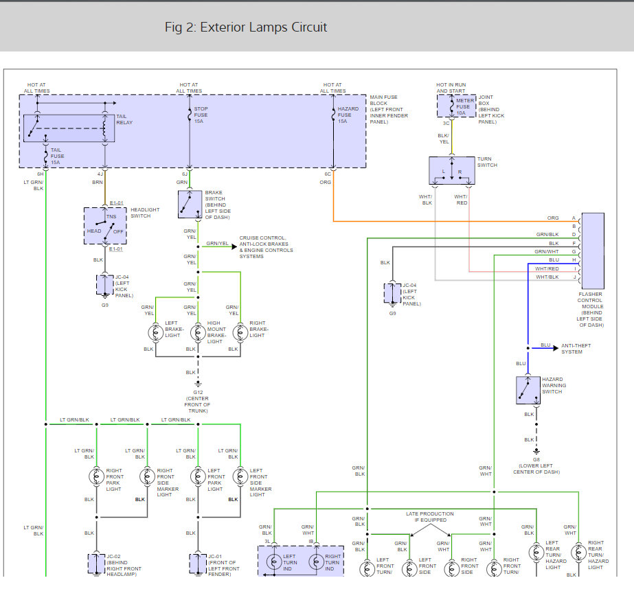

2002 protege 5, While driving I lose my dash board and rear lights, so I check my fuses, found the blown one and replaced with a good new one, turned my head lights on and it blows right away, I took both back tail lights out and tried a new fuse with the lights out of the holder and the fuse blows right away again, so I took the instrument cluster out and put in a new fuse with it out and the same thing happens, my head lights and turn signal lights, radio, inter lights all work just fine, so I'm pretty sure I have a short some place, but any idea as to the best place to start from?
Feb 13, 2008 at 1:25 AM
  • 54,837 POSTS

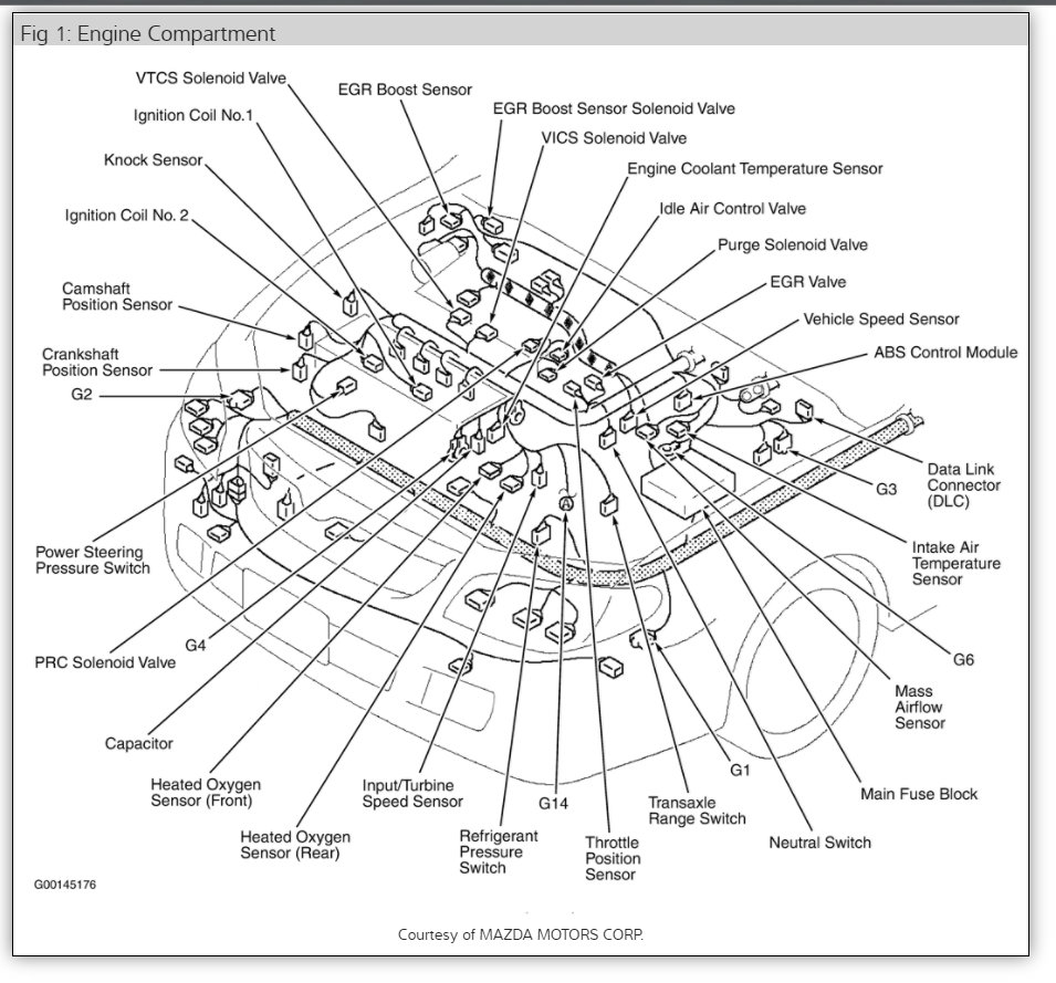

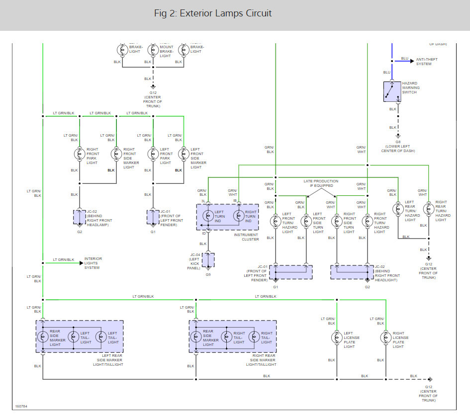

It sounds like you have a tail ight control relay that has gone bad but to be sure please follow this guide to test the relay.
If the relay checks out okay you need to check for a power wiring touching ground and the best way to do that is follow this guide to find the problem.
Here are the tail light wiring diagrams and relay and fuse panel locations (below)
Please run some tests and get back to us.

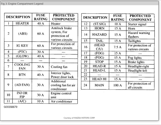

Hi yayo26,
Check the underhood fuse for taillight.

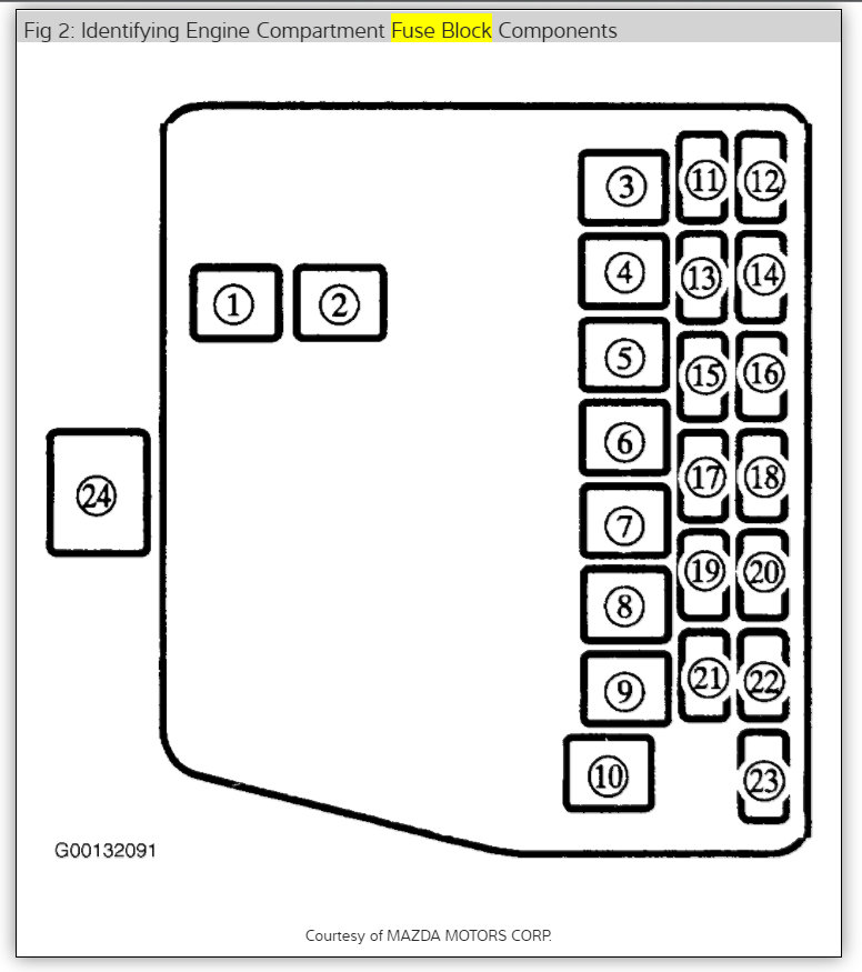

  • 75,992 POSTS
Check the tail fuse 15amp in the main fuse box if its blown if okay-test or swap the TNS relay with a similar one at right rear corner of engine compartment
