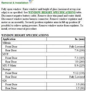

QUESTION 2: What would be the easiest way to de-install and re-install the front left window to replace the window regulator?

Try finding one at a junk / salvage yard or online sites such as craigslist or ebay.
https://images.2carpros.com/forum/automotive_pictures/261618_Noname_2392.jpg
