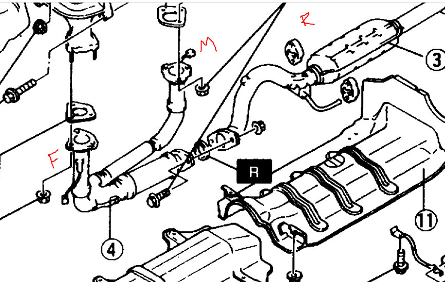

I have a 2000 Mazda Millenia V6 2.5 liter, with 76,000 miles. Can you tell me where the catalytic Converter is located. I need to replace the oxygen sensor that is against the firewall?

yes I am sure its a 2.5. The problem is... I need to replace the oxygen sensor that is against the firewall on the left hand side if facing the car. I dont know which sensor to buy. either the upstream or the downstream. Can someone tell me?

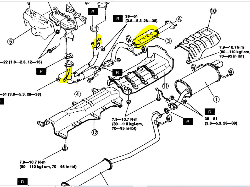

There are a total of three sensors on this vehicle. If the sensors are under the hood and near where the exhaust manifold and downpipe attach, those two will be upstream. There is a third one further back on the exhaust.
I attached two pics below. In the first one, I highlighted the catalytic converter as well as the sensors. In pic 2 I identified the three as front, middle, and rear. That is how they are identified. The front and middle are upstream.
joe
