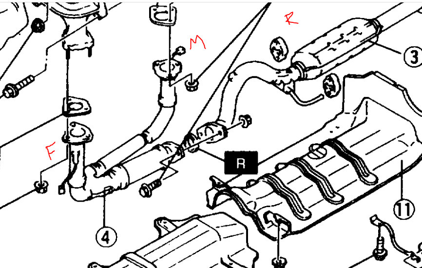

I have a 2000 Mazda Millenia V6 2.5 liter, with 76,000 miles. Can you tell me where the catalytic Converter is located. I need to replace the oxygen sensor that is against the firewall?

yes I am sure its a 2.5. The problem is... I need to replace the oxygen sensor that is against the firewall on the left hand side if facing the car. I dont know which sensor to buy. either the upstream or the downstream. Can someone tell me?

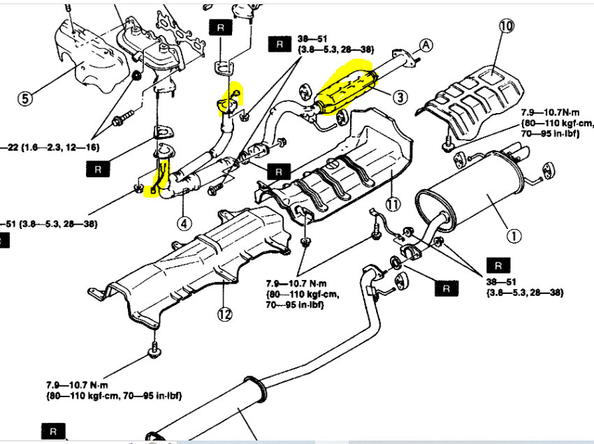

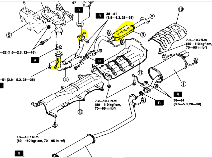

There are a total of three sensors on this vehicle. If the sensors are under the hood and near where the exhaust manifold and downpipe attach, those two will be upstream. There is a third one further back on the exhaust.
I attached two pics below. In the first one, I highlighted the catalytic converter as well as the sensors. In pic 2 I identified the three as front, middle, and rear. That is how they are identified. The front and middle are upstream.

Identify the sensor by exhaust position before buying. The two sensors under the hood where the exhaust manifold meets the downpipe are the front and middle upstream sensors. The third sensor, farther back on the exhaust, is the rear sensor. Match the replacement to that location.
