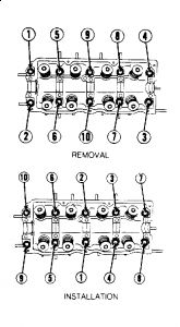

Hi Cylinder head has warped if exhaust gas entered water jacket. How much was milled off head? was head torqued as in diagram
https://images.2carpros.com/forum/automotive_pictures/198357_Graphic_377.jpg
at 59 -64 ft. lbs.? Let me know Thanks for donate

I can't find the paperwork that tells how much was milled off but I think it was straight before they did it so it was just to resurface the head.
And for removal/instalation, those are the same bolt patterns and ft/lbs that I used.
