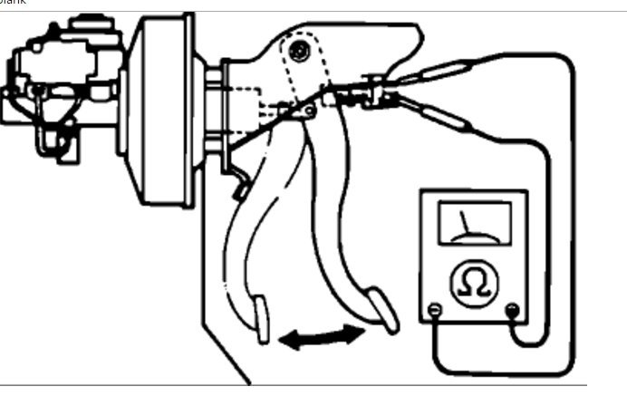

brake lights won't work. The turn signals and reverse lights do work, just the brake lights don't work. We have replaced all the bulbs in the tail light and all fuses. Could it be the brake light switch? Can someone tell me where the brake light switch is located and how to test/change it out?
Jun 17, 2020 at 10:25 AM (Merged)
  • 54,840 POSTS
The brake light switch is located by the top of the brake pedal, you can test it using a test light, here is a guide that shows how to test it and a diagram that shows the location (below)
Please run this test and get back to us so we can continue helping you.
Best, Ken
