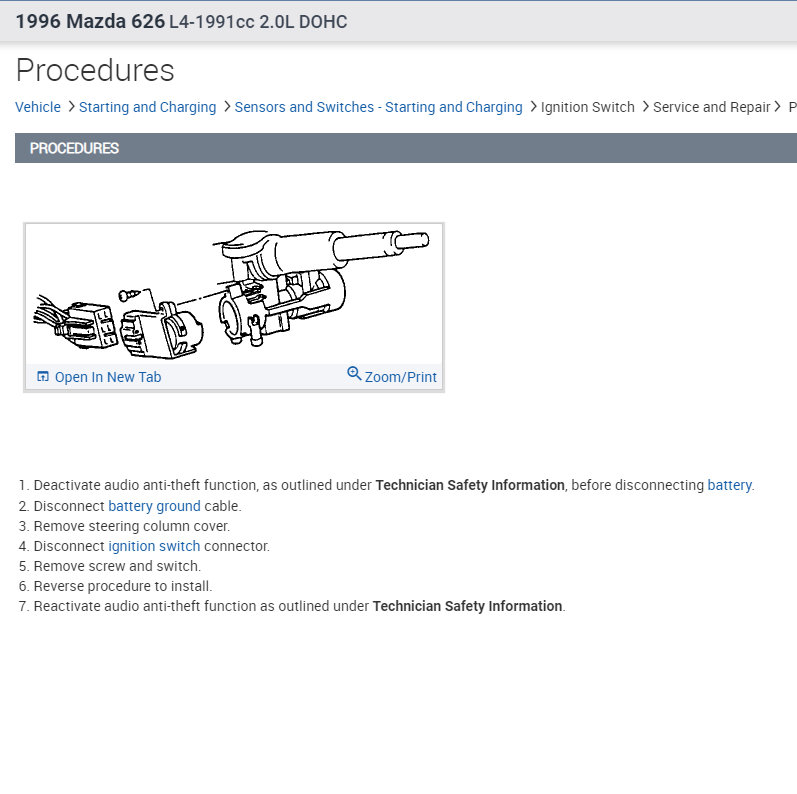

i replaced starter, went to crank, won't crank, not getting fuel or fire?

If the engine is not cranking over it will not produce spark or fuel.
When you turn the key and it only clicks or does not make any noise then the issue could be a weak battery, faulty starter, bad connection to the starter, or an ignition switch. It can also be due to wiring issue.
Let me know what you are experiencing. Is it making any clicking noise?
Just so cover the basic. Have you tried to jump start the vehicle?
https://www.2carpros.com/articles/how-to-jump-start-car-battery-using-jumper-cables
If you are getting no noise while trying to start it could be due to a bad ignition switch. The ignition switch is the electrical component that the lock cylinder attaches to.
Over time it can have burnt pin(s) and can cause the engine not to start.
Please let me know little more details of the issues that you have.
