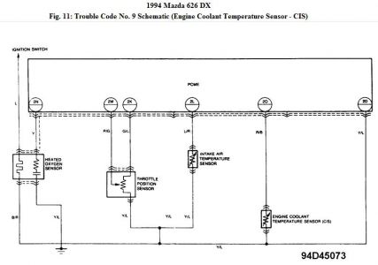

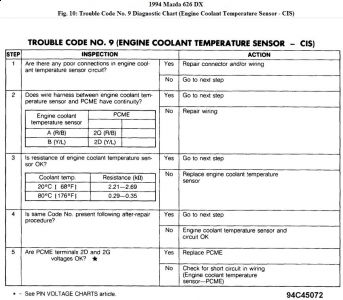

I replaced the PCM. Fuel pump primes when starter is energized. Engine still will not start. Got a 9 code when checked code at DLC. A check of code show coolant temperature sensor or circuit. How is the temperature sensor checked? Will this prevent starting?
Sunday, December 6th, 2009 AT 8:21 PM
KHLOW2008
  • 41,814 POSTS
Yes, the ECT can cause difficult or non starting as the fuel metering is affected.
Here are the diagnostic procedures and schematic. They might not show up well due to the size and I will send another pdf copy to your email for you.
Since engine had been idle for a long period of time and the compression seems rather low, remove the spark plugs and squirt some engine oil into the cylinders via the spark plug holes. Crank the engine to get the compression up and reinstall the spark plugs to test.
http://www.2carpros.com/forum/automotive_pictures/192750_Code9_94Mazda626Fig10_1.jpg
http://www.2carpros.com/forum/automotive_pictures/192750_Code9_94Mazda626Fig11_1.jpg
