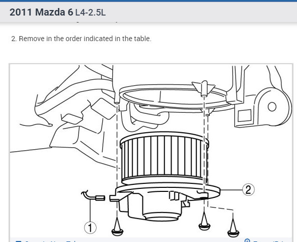

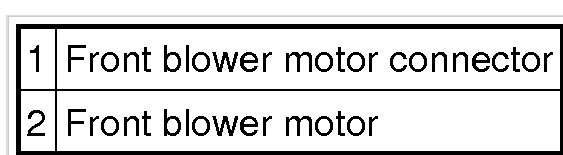

Hello again.
It's possible the blower motor has a faulty/noisy bearing. Here is a tutorial showing how to remove/replace:
https://www.2carpros.com/articles/blower-fan-motor-works-on-high-speed-only
I've attached step replacement pictures below. This is for an automatic control system.Hope this helps and let me know if you have any more questions. Thanks again for using 2CarPros

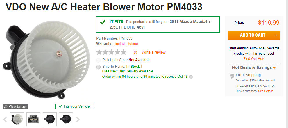

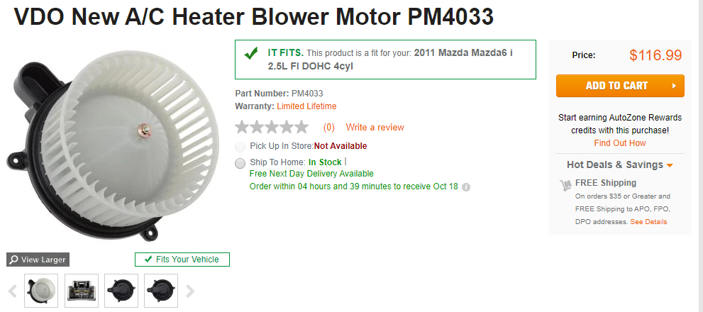

DANNY L
  • 5,648 POSTS
You're welcome!
Let me know how things turn out.. I've attached a picture from AutoZone. You will be looking at about $120.00. Dealership prices are more. Hope this helps and thanks again for using 2CarPros.
