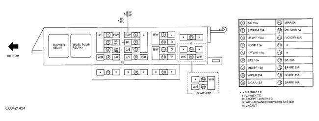

When I turn off my car the air conditioner will not turn off unless I put it in the off position. When I put it on one two three or four it runs as if the car was on. I have the car all the way off I don't have it on the acc position

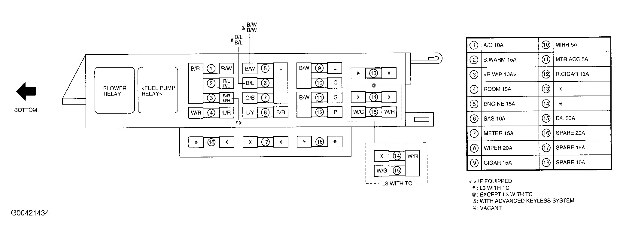

sounds like you've got a relay sticking for the blower motor relay. heres a pic. with the air on and the key off gently rap on this relay and see if the blower stops. this block is under the drivers side dash
