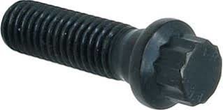

I ran into another obstacle again. When I was checking for the socket size for the head bolts I used a 6 point 13mm and it fit well so I assumed that I needed to buy the same size socket but a 12 point. No when I tried the 13mm 12 point socket on the head bolt it was loose. What is the correct socket to use to remove the head bolts on this engine? Should I just use the 13mm 6 point socket or buy another socket 12 point socket with a smaller size? I did not know that 6 points and 12 points have different 13mm socket sizes.
Aug 26, 2018 at 5:19 PM
If you used the 13mm 6 point to remove it then use the 6 point to install.
The 12 point does not have the grip of the 6 point.
Aug 26, 2018 at 6:47 PM
RINKI DINK
  • 21 POSTS
But the bolt heads of the bolts look like 12 points. I did not remove it yet as I am contemplating on what socket I should use. It looks something like this (pls image). Is it safe to use a 6 point socket on a 12 point bolt head?
Aug 26, 2018 at 9:31 PM
Nope. Check and see if a 1/2 12 point is any tighter. Otherwise, you may need a different socket for the 13mm.

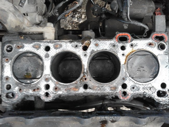

Already removed the cylinder head. How do I clean all of these? Thanks!
Aug 28, 2018 at 10:03 PM
Okay, you will need an air drill or electric drill with an adapter to use what is called cookies. They are nn abrasive discs that will remove gasket material without damaging the block surface.
You can get them at a parts store. Get a box of the cookies. They are cheap but you will need to get the adapter to fit the cookies.
Aug 28, 2018 at 11:07 PM

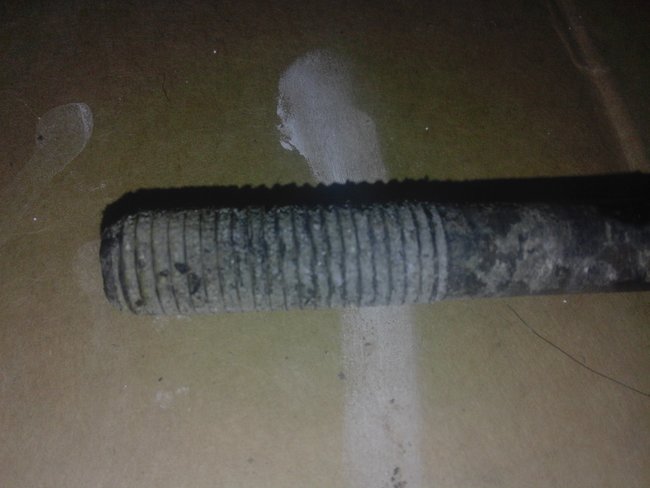

Okay, I will try to look for those. I noticed something about head bolt number 5. Is this something to be worried about? My guess is that coolant seeped in its bolt holes and left some sediments on the threads when it dried up. Am I correct? Please see picture.
Aug 29, 2018 at 3:33 PM
Yes, that is correct.
I would run a tap down and clean up the threads. Take one of the bolts with you to get the exact thread pitch for the tap.
The 5 is most likely a production line number.

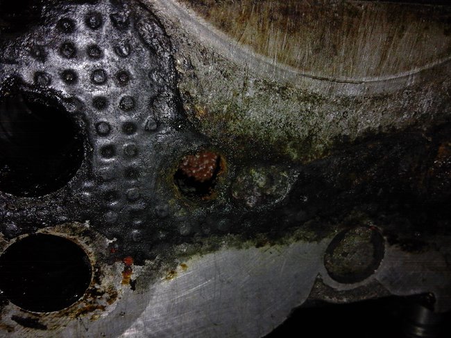

As I was cleaning the cylinder head surface I came upon a big pitting. Will this be an issue?
Aug 29, 2018 at 8:58 PM
Clean the top of the entire block and then we will take a look.
Aug 29, 2018 at 9:11 PM
