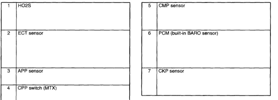

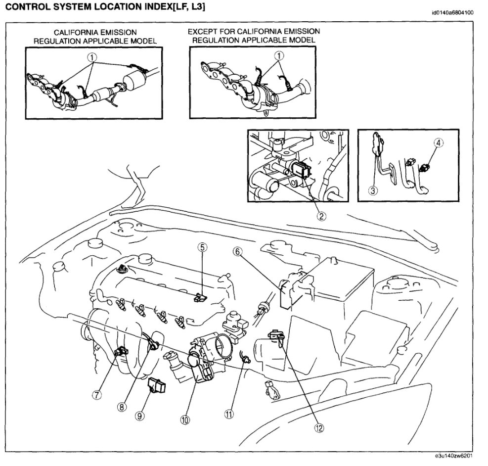

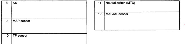

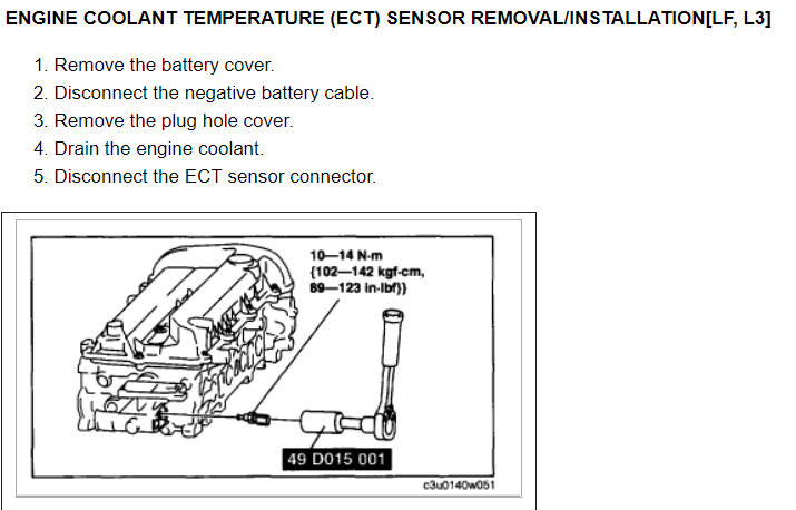

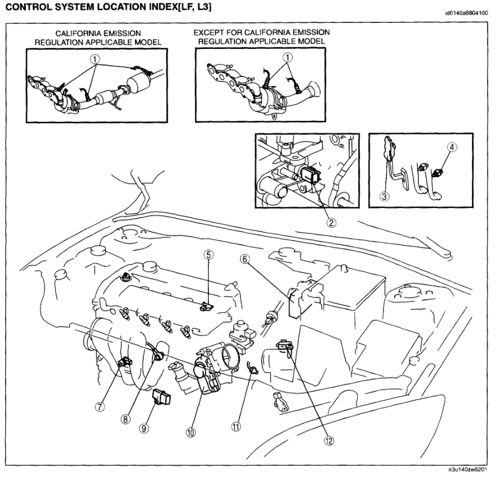

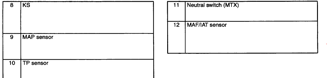

It sounds like you have an engine coolant temperature sensor issue. When these sensors get a little off the computer cannot pick up the problem so it will not trigger a check engine light. Here are guides to help us get started fixing the problem:
https://www.2carpros.com/articles/coolant-temperature-sensor-cts-replacement
and
https://www.2carpros.com/articles/engine-cranks-excessively-before-starting
Here is how it will be on your car.
