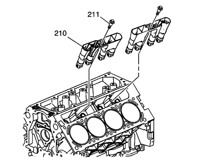

2. Remove the valve lifters. Refer to Valve Lifter Replacement (L92 - First Design) (See: Lifter / Lash Adjuster, Valve > Removal and Replacement > Valve Lifter Replacement (L92 - First Design))Valve Lifter Replacement (L92 - Second Design) (See: Lifter / Lash Adjuster, Valve > Removal and Replacement > Valve Lifter Replacement (L92 - Second Design))Valve Lifter Replacement (LY2 and LY6) (See: Lifter / Lash Adjuster, Valve > Removal and Replacement > Valve Lifter Replacement (LY2 and LY6))Valve Lifter Replacement (LH6, LMG, LY5 and L76) (See: Lifter / Lash Adjuster, Valve > Removal and Replacement > Valve Lifter Replacement (LH6, LMG, LY5 and L76)) .

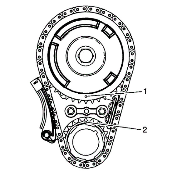

6. Rotate the crankshaft sprocket until the camshaft sprocket alignment mark (1) and the crankshaft sprocket alignment mark (2) are aligned.

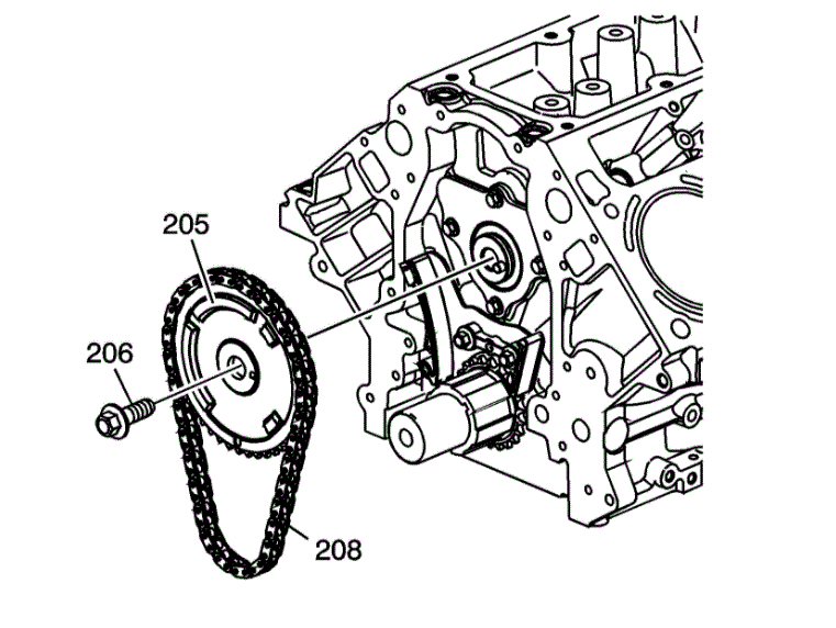

7. Remove the camshaft sprocket bolt (206).
8. Remove the camshaft sprocket (205) and timing chain (208).

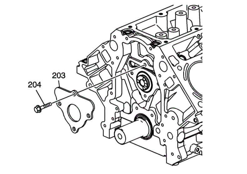

9. Remove the camshaft retainer bolts (204) and retainer (203).

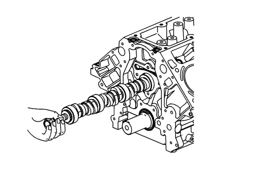

Notice: All camshaft journals are the same diameter, so care must be used in removing or installing the camshaft to avoid damage to the camshaft bearings.
10. Install the camshaft sprocket bolt into the camshaft front bolt hole.
11. Using the bolt as a handle, carefully rotate and remove the camshaft from the engine block.
12. Remove the bolt from the camshaft.
