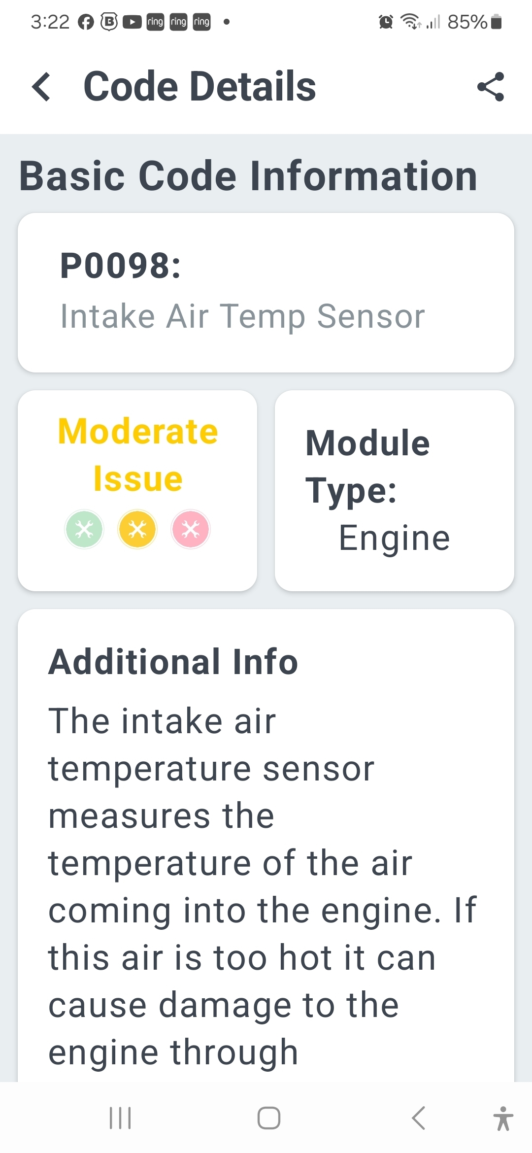

Fixd found the code, yesterday my scan tool said no codes today it had the same error as the fix.

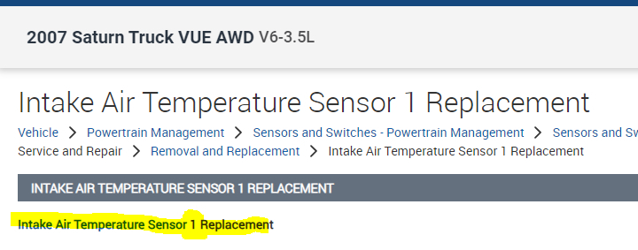

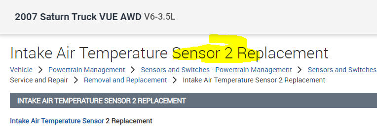

Intake air temp sensor.
Tuesday, September 3rd, 2024 AT 9:19 PM

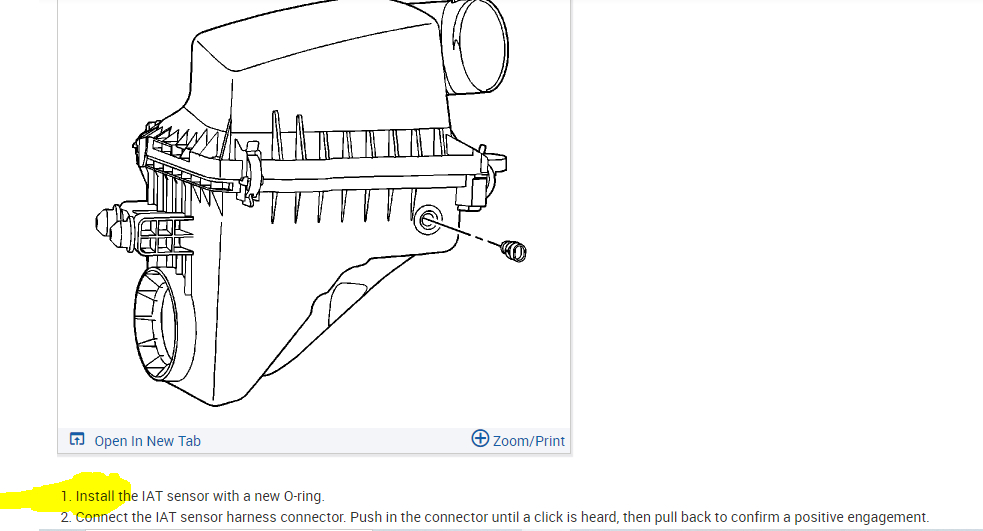

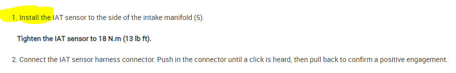

  • 109,885 POSTS

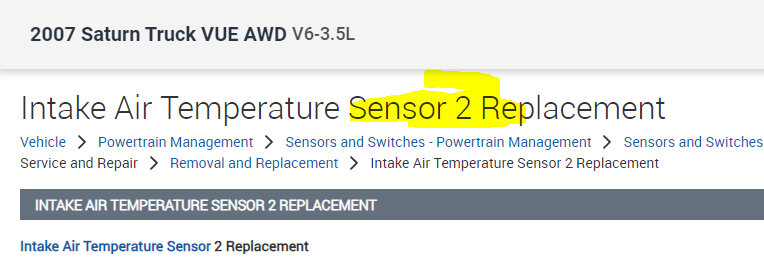

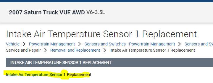

There are two on this vehicle. Yes, you could replace them. It isn't a difficult job.
If you look below, I attached the directions for both sensor 1 and sensor 2. Take a look through them and let me know if that helps or if you have additional questions.

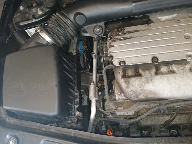

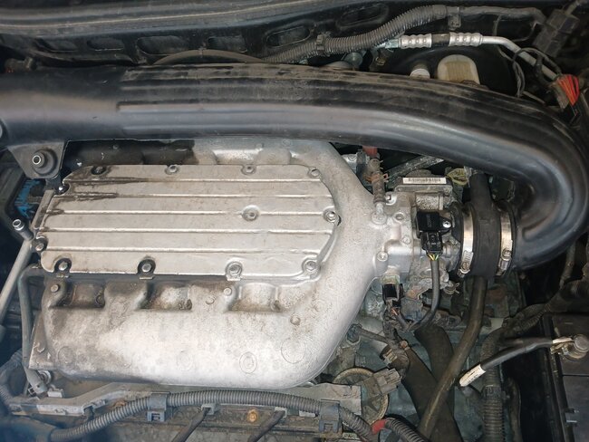

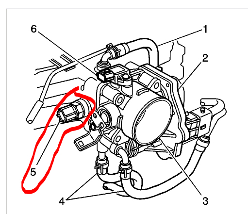

Do I ask for a sensor O ring? I have to find where the intake manifold is, can't tell by the pic.
Wednesday, September 4th, 2024 AT 10:56 PM
SHERILYN FRANKLIN

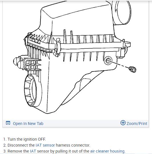

  • 88 POSTS
I put one at sensor under the air filter, where does the other one go?
Thursday, September 5th, 2024 AT 9:52 AM

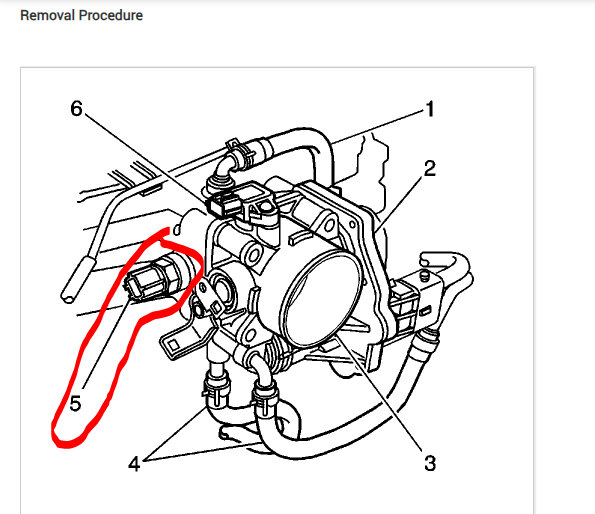

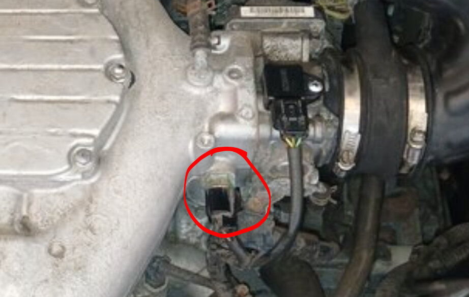

  • 109,885 POSTS
Confirm that the sensor you have is the same as the one I circled below. I believe that is the second one. It's hard to orient myself with the pic.
See pic below.
Thursday, September 5th, 2024 AT 7:05 PM
SHERILYN FRANKLIN
  • 88 POSTS

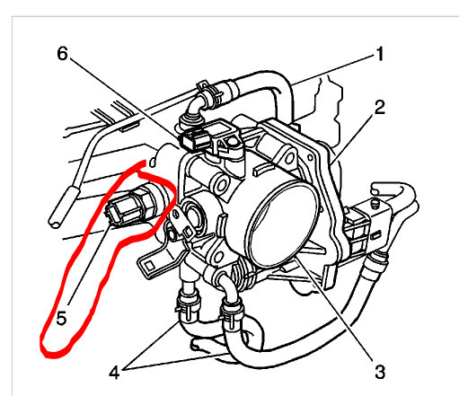

Is that the AIT sensor? The one I have is identical to the mass air flow sensor under the air filter.
Thursday, September 5th, 2024 AT 9:29 PM
  • 109,885 POSTS
Based on what the manual is showing me, I believe it is the IAT. Take a look at the attached picture below. The manual identifies that as IAT 2. It also identifies the one in the air box as IAT 1. It should be right behind the throttle body.

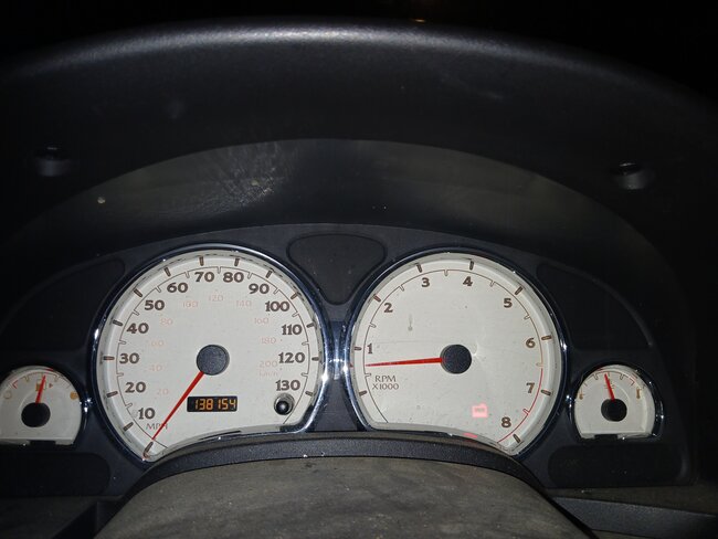

  • 88 POSTS

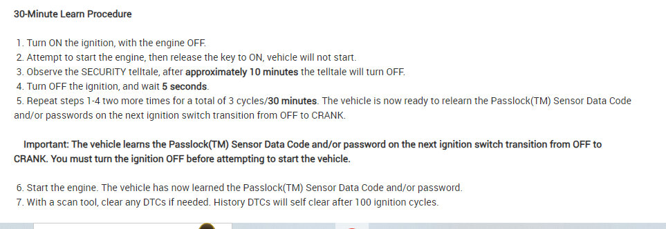

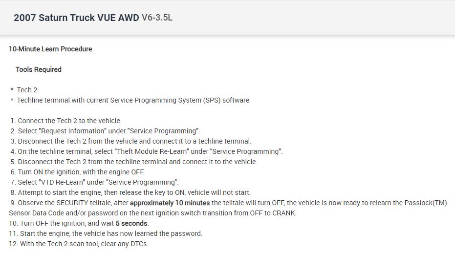

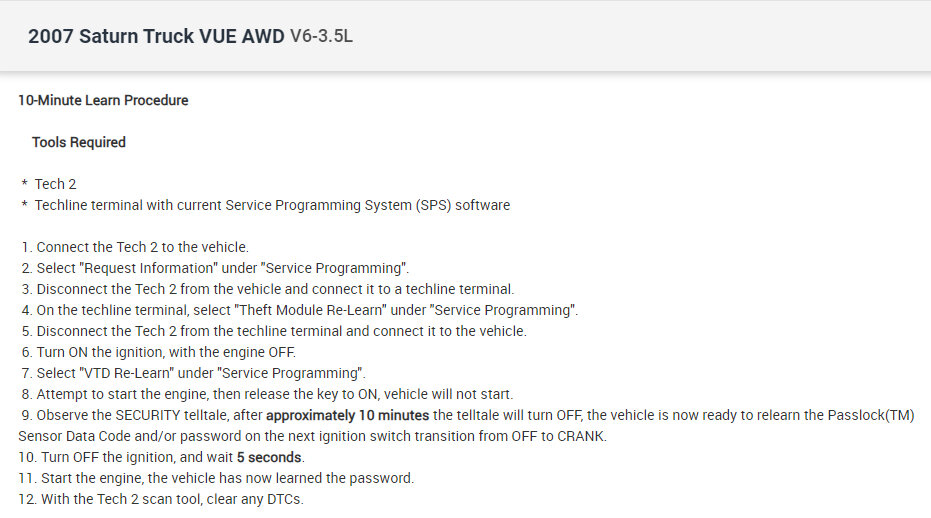

I installed the IAT sensor and did a scan it didn't detect any error but the dash still has the error code. And I would like to know if I can use a scan tool to program my key fob.
Tuesday, September 17th, 2024 AT 8:54 PM
  • 109,885 POSTS
Did you try clearing the codes with the scan tool?
Wednesday, September 18th, 2024 AT 5:39 PM
SHERILYN FRANKLIN
  • 88 POSTS
I will try and what about my second question?
Wednesday, September 18th, 2024 AT 9:12 PM
  • 109,885 POSTS
The scanner really isn't needed for a relearn related to the key fob. Also, I'm not sure if you have a bi-directional scanner that can communicate in both directions.
As far as the relearn, you can use a scan tool or you can do it without the scan tool. I attached directions below for both procedures.
