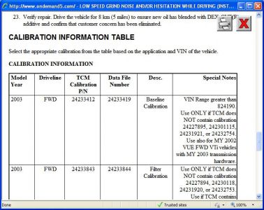

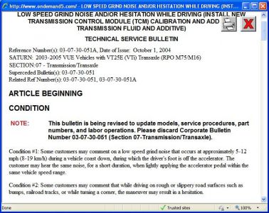

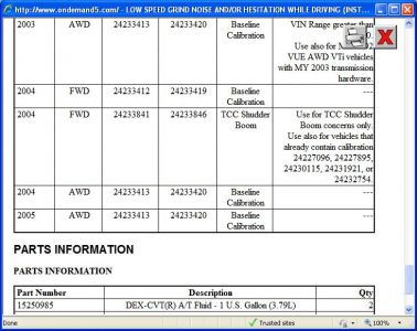

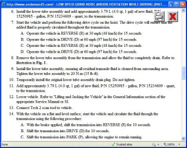

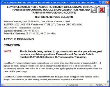

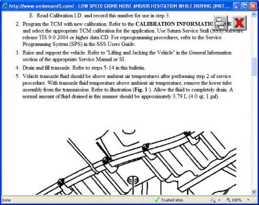

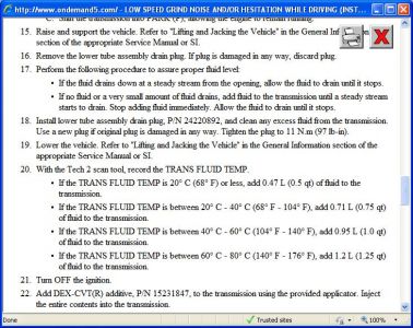

https://images.2carpros.com/forum/automotive_pictures/416332_2003_vue_trans_noise_part1_1.jpg
https://images.2carpros.com/forum/automotive_pictures/416332_2003_vue_trans_noise_part15_1.jpg
https://images.2carpros.com/forum/automotive_pictures/416332_2003_vue_trans_noise_part2_1.jpg
https://images.2carpros.com/forum/automotive_pictures/416332_2003_vue_trans_noise_part3_1.jpg
https://images.2carpros.com/forum/automotive_pictures/416332_2003_vue_trans_noise_part4_1.jpg
https://images.2carpros.com/forum/automotive_pictures/416332_2003_vue_trans_noise_part5_1.jpg
https://images.2carpros.com/forum/automotive_pictures/416332_2003_vue_trans_noise_part6_1.jpg
https://images.2carpros.com/forum/automotive_pictures/416332_2003_vue_trans_noise_part7_1.jpg
https://images.2carpros.com/forum/automotive_pictures/416332_2003_vue_trans_noise_part8_1.jpg
https://images.2carpros.com/forum/automotive_pictures/416332_2003_vue_trans_noise_part9_1.jpg

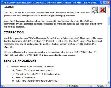

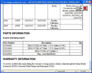

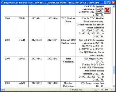

i know it says its for a grinding while in gear while driving slow speeds but it still applies to your vue.its the first step for repair and if that doesnt work then you will have to get a pressure test performed on your transmission if ur pressures are good then you will only need a internal filter and a side cover which is your input shaft,output shaft,and your belt between the two shafts.its like a rebuild kit for your vue.if your pressures are low in your transmission then you will need a pump or valve body depending on the pressures and a side cover and internal filter.as long as they dont find anything else wrong in your transmission.I have worked for saturn for over 16yrs iam a trained tech for saturn.the transmission u have in your vue had alot of problems thats why they stopped using them in the 04 vue.if they go into your transmission it will get real expensive and you will have to decide if u want to keep it or get something else.let me know if you have anymore questions.also thank you for your donation and for using 2carpros.
