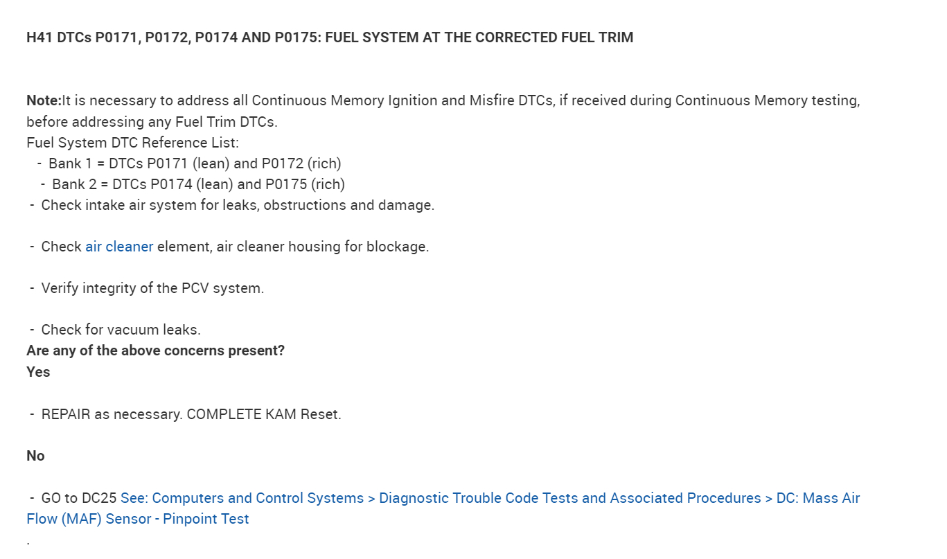

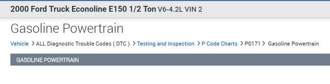

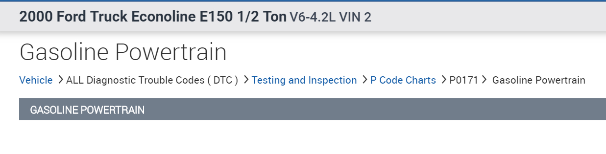

SCGRANTURISMO
  • 4,897 POSTS
In the diagrams down below I have included the factory diagnostic troubleshooting guide for Direct Trouble Code (DTC) P0171. I see no listing for DTC P1133 listed for your vehicle. If you double check the DTC number for me I will be happy to look it up for you. The guide for DTC P0171 is pretty straight forward. I would definitely check for vacuum leaks. By vacuum leaks, what I mean is any unmetered, or any air leaking into the intake air system after the Mass Air Flow sensor (MAF). A good way to do this is to get a propane torch and crack it open on the lowest setting, making sure not to light it. You just want the propane coming out of it. With the engine running, run the propane torch along the air intake duct, throttle body, intake manifold, vacuum hoses, EVAP hoses, paying special attention to Positive Crankcase Ventilation hoses, EGR inlet, and the intake manifold, both inside the valley and outside. Anywhere there is a leak when the torch passes by it the engine rpm's will pick up as the propane will get sucked into the system. This will take care of this DTC. I have also included a link below for you to go to:

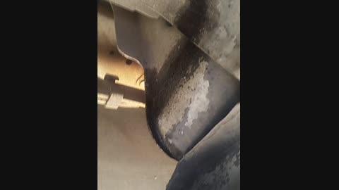

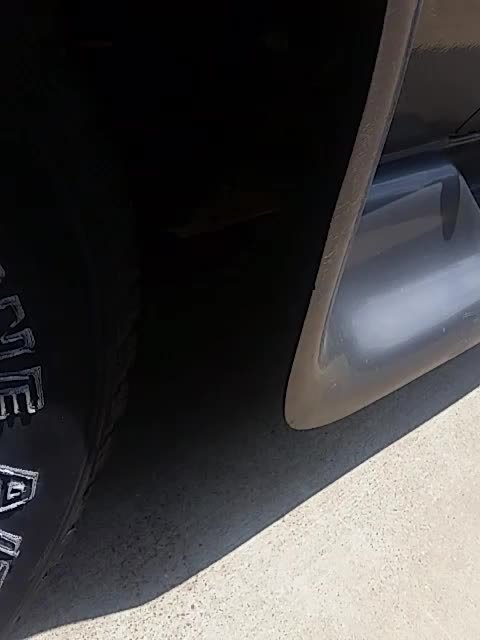

Okay i will try that. I have a quick question though. Yesterday i came home and something caught my eye and i saw this dark line in my passenger side back fender well. Come to find out i have a wheel cylinder leak. Would this cause a service engine soon light to come on? here is a video of it. i tried to record it the best i could.

SCGRANTURISMO
  • 4,897 POSTS
Hello again,
It might cause the MIL to illuminate with an ABS DTC. The only way to know for sure is to get a code reader and pull the code(s). This will also allow you to erase the DTC(s) when the problem(s) are fixed. Here is a link below with how to pull the DTC(s) if you are unfamiliar with how to do this.

BMDOUBLE
  • 1,139 POSTS
A wheel cylinder leak will not cause a mil light to turn on, specifically an ABS light. And clearing the code will be like brushing dirt under a rug. As the vehicle is running lean the PCM is adding fuel to compensate so your fuel economy will suffer for sure! The vehicle may run “fine”, but over time this is not good for the engine. I used to get a lot of these at my dealership because most techs don’t want to do the work. I would shop around at other shops, specifically Ford specialty shops. Not trying to step on any toes, just my opinion.

Update: Its not about the intake manifold gaskets but it is about the wheel cylinder leak. Or so i thought it was. Turns out my axle grease is leaking out and i need a new seal. So i just wanted to post this just in case someone sees the same black oil line inside their fender well and may not know what it is. Mine turned out to be axle grease etc

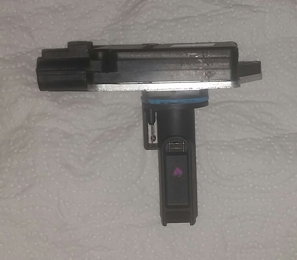

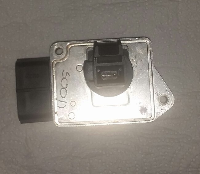

WARREN1814
  • 218 POSTS
Here's what it looked like the mass air flow sensor we took off ourselves. Plus it was a remanufactured one too. I had a brand new one on there before the repair shop replaced it with this one.

SCGRANTURISMO
  • 4,897 POSTS
Hello again,
Usually, junk yards or pick n pull places will put red dots on parts that they recycle that are in good working order, so that's nothing to worry about. What you need to worry about on MAF's is the two fine platinum wires. You can purchase MAF cleaner at any auto part store specifically formulated for cleaning these wires. It is manufactured by CRC and dries very quickly so as not to damage these wires. The way a MAF sensor works is these two platinum wires heat up to 500 or so degrees. As the air flows past these wires as it is entering your engine, the wires cool down and more electricity is needed to be added to heat them back up to 500 degrees. The PCM is able to read this electricity and correlates it into the amount of air entering the engine. If there is corrosion, or a bug, or something on the wires, then more electricity is going to added, and the information that the PCM gets will be skewed. Anyway, please keep us informed as to your progress.
