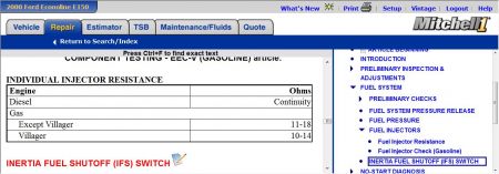

4. Tested resistance which was 16.2 ohms (9-16 is normal).

E150 van
Same thinking on clogging-see below
https://www.2carpros.com/forum/automotive_pictures/12900_inj_4.jpg

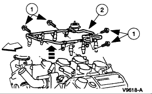

https://www.2carpros.com/forum/automotive_pictures/12900_e1_1.gif

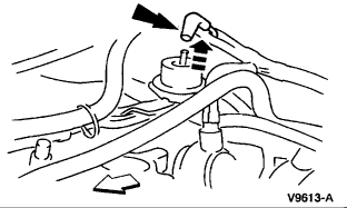

Remove the fuel pressure regulator valve vacuum hose.
Disconnect the fuel lines.

Remove the fuel injection supply manifold.
Remove the bolts.
https://www.2carpros.com/forum/automotive_pictures/12900_e4_1.gif

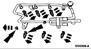

Remove the six fuel injector retaining clips and the fuel injectors. Inspect the fuel injector O-rings and if necessary, install new. CAUTION: The fuel injectors are deposit-resistant. Do not clean. Use O-rings made of special fuel resistant material. Use of ordinary O-rings can cause the fuel system to leak.

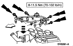

https://www.2carpros.com/forum/automotive_pictures/12900_e5_1.gif
To install, reverse the removal procedure. CAUTION: The injector clips must engage the upper groove on the injectors or fuel leaks may occur. NOTE: Lubricate the new O-rings with clean engine oil, XO-10W30-QSP or DSP or equivalent meeting Ford specification WSS-M2C153-G, to aid installation.

Well I unbolted the upper intake, and removed the air filter box, that allowed me to raise the drivers side of the intake, and support it with a piece of wood. I unbolted the drivers fuel rail and was only able to raise it enough to get access to the 2 rear drivers side injectors. I replaced the one in the middle (number 5). Made sure to put new o rings on, out everything back together. It fired up quickly like a honda and ran perfectly! This was my last resort. If this didnt fix it, she was going up for sale! Thanks for all of your time and help!
