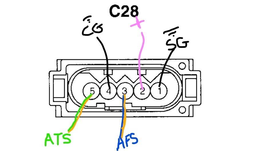

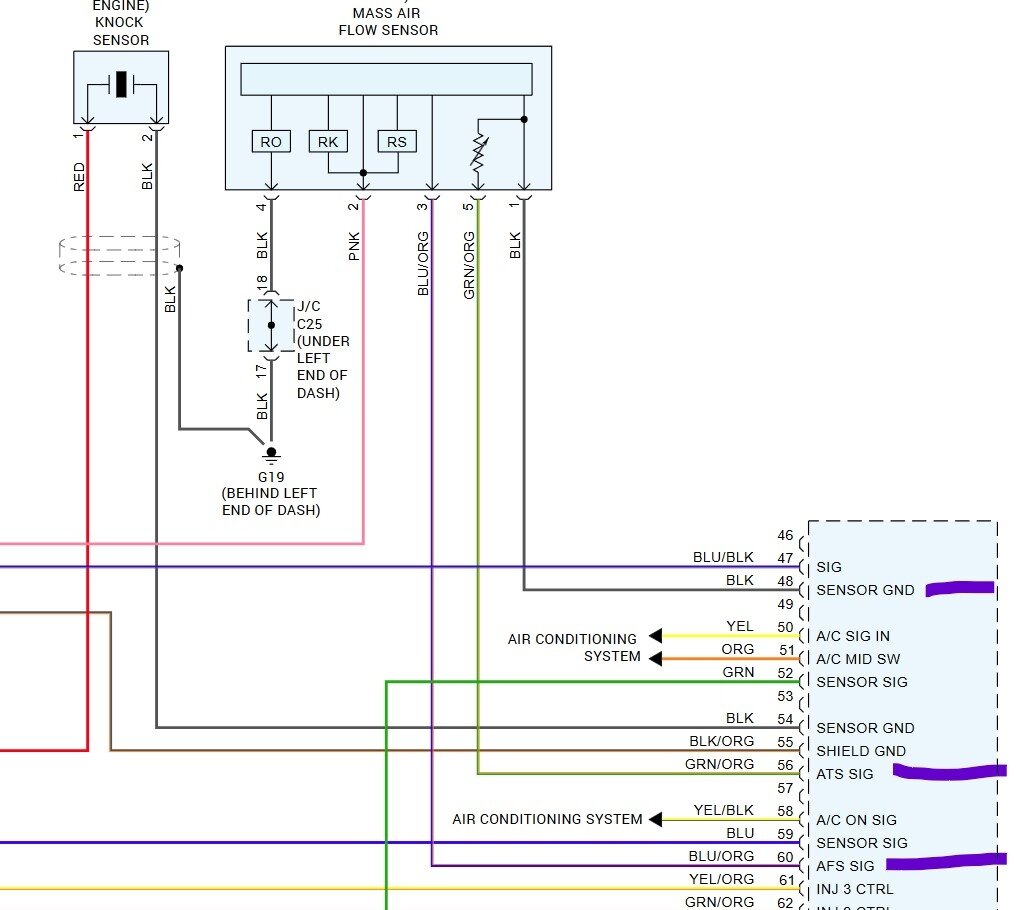

Did a resistance test on mass airflow sensor with the following result...
power to ground 14.3 ohm
ground to temp sensor 2.3 ohm
no reading on ground to input
The power to ground reading seems high to me, and I am unsure of the ground to temp reading, do any of these indicate that I have a failed or failing sensor?

Resistance tells you nothing because of the way a MAF is made internally. All it tells you is that things are connected inside. That is why there are no published specifications other than the voltage response curve. What matters is the voltage signals from the temperature and MAF sensor sections. Those are measured with a scan tool or by back probing the MAF with it in operation. Then you look at the voltage curve and look for skewed readings or a bad curve or lack of one. In your case you should see about .5 volts at idle and about 1 volt at 3000 RPMs. That would be the voltage between pins 1 and 3 on the diagram for flow rate. For the air temperature it's easier, the scan tool will tell you the temperature of the air intake and ambient air, on a parked car they should be within a degree or two, if you see -40 the temporary sensor is broken or disconnected, +140 means it's shorted. What is the issue you are having? Any codes or CEL on?

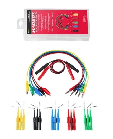

A scan tool would tell you a lot more than any other testing. As for back probe testing, you use a needle or a kit like in the image, they are very thin probes that go between the insulation and the seal with no damage. Unfortunately, these days even simple repairs need a scan tool that can read live data at a minimum.
Something like this would work and give you the ability to deal with most issues for a long time.
https://www.topdon.us/collections/diagnostic-tools/products/artidiag-pro
