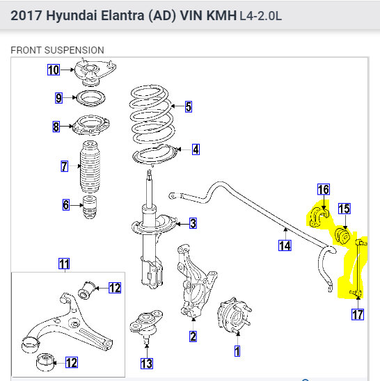

The first things I would check would be the stabilizer links and make sure the sway bar is tight and the bushings are good. I'm trying to think of what they may have done by replacing the brake hoses, but there isn't much.
Don't laugh but check to make sure the wheels are tight. LOL
I attached a pic below and highlighted the links and bushings to check. Also, make sure there isn't a loose wheel.
Social media isn't a good thing when one is a teacher. Ugh! I can only imagine how bad that could end up.
Let me know what you find.
See pic below.

Thank you, I'll check those and see. If it's not that could it be the control arm?
Sunday, November 6th, 2022 AT 12:00 AM
  • 109,913 POSTS
If there is a worn bushing, yes it can make noise. If you lift the front off of the ground, see if there is any play in the wheel.

Well, I found out the clunking noise was a broken bottom motor mount. At least it is getting fixed.
Monday, November 7th, 2022 AT 8:05 PM
  • 109,913 POSTS
Interesting. Usually, that is heard when placing the vehicle in gear or loading the engine. Is the part being installed by a shop or do you plan to do it yourself?

You're not a pain, lol. It was the hydraulic upper mount that was broken. And as I would drive the motor would move so good thing, I took it in, lol. But I got it back yesterday evening and so far, it is running great. Every now and then I smell a weird smell, but I think it's the new brakes, rotors and calipers at least, I hope.
